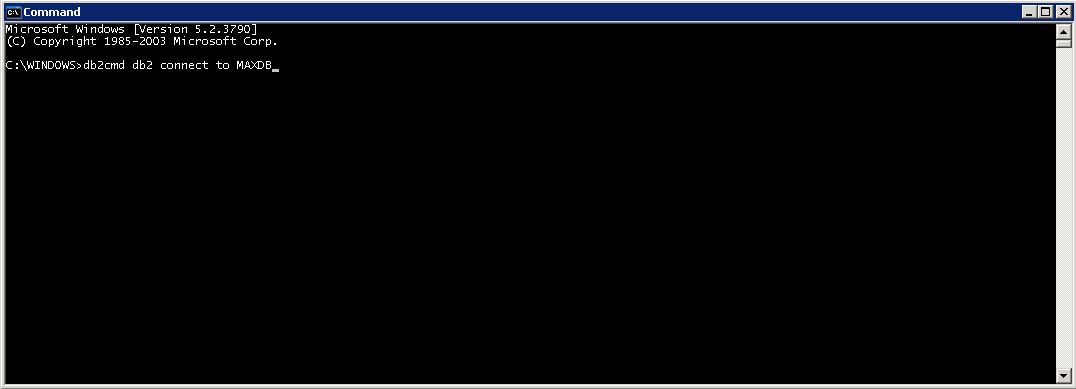

In order to prevent this error to happen, before the second execution of the 7.5.0.x installer where the updatedb will be performed you have to increase the size of the applheapsz parameter in the Maximo database. To do that, using a command window, execute the following commands:
- db2cmd db2 connect to <DB_ALIAS> [ENTER], where <DB_ALIAS> is the name of your Maximo DB2 database
In the window that will open:
- db2 update db cfg using applheapsz 8192 [ENTER]
- db2 connect reset [ENTER]
Close the window, but connect again, now, in order to check if the parameter was updated correctly:
- db2 get db cfg [ENTER]
- check in the results if the applheapsz parameter is now set to 8192
- close the window
At this point, you can perform the second execution of the 7.5.0.x to perform the updatedb and not getting the error mentioned.
