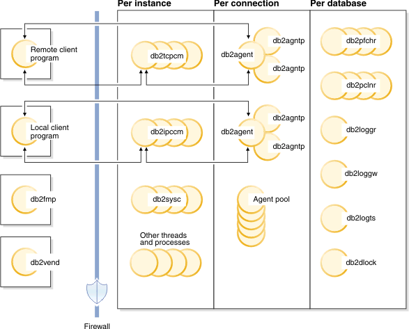

![Graphic representation of the process model for Db2database systems](00052893.gif)
Client programs
Client programs can be remote or local, running on the same machine as the database server. Client programs make first contact with a database through a communication listener.
Listeners
- db2ipccm, for local client connections
- db2tcpcm, for TCP/IP connections
- db2tcpdm, for TCP/IP discovery tool requests
Agents
All connection requests from local or remote client programs (applications) are allocated a corresponding coordinator agent (db2agent). When the coordinator agent is created, it performs all database requests on behalf of the application.
In partitioned database environments, or systems on which intraquery parallelism is enabled, the coordinator agent distributes database requests to subagents (db2agntp and db2agnts). Subagents that are associated with an application but that are currently idle are named db2agnta.
- Connected to the database with an alias; for example, db2agent (DATA1) is connected to the database alias DATA1.
- Attached to an instance; for example, db2agent (user1) is attached to the instance user1.
The Db2 database server instantiates other types of agents, such as independent coordinator agents or subcoordinator agents, to execute specific operations. For example, the independent coordinator agent db2agnti is used to run event monitors, and the subcoordinator agent db2agnsc is used to parallelize database restart operations after an abnormal shutdown.
A gateway agent (db2agentg) is an agent associated to a remote database. It provides indirect connectivity that allows clients to access the host database.
Idle agents reside in an agent pool. These agents are available for requests from coordinator agents that operate on behalf of client programs, or from subagents that operate on behalf of existing coordinator agents. Having an appropriately sized idle agent pool can improve performance when there are significant application workloads. In this case, idle agents can be used as soon as they are required, and there is no need to allocate a new agent for each application connection, which involves creating a thread and allocating and initializing memory and other resources. The Db2 database server automatically manages the size of the idle agent pool.
A pooled agent can be associated to a remote database or a local database. An agent pooled on a remote database is referred to as a pooled gateway agent (db2agntgp). An agent pooled on a local database is referred to as a pooled database agent (db2agntdp).
db2fmp
The fenced mode process is responsible for executing fenced stored procedures and user-defined functions outside of the firewall. The db2fmp process is always a separate process, but might be multithreaded, depending on the types of routines that it executes.
db2vend
The db2vend process is a process to execute vendor code on behalf of an EDU; for example, to execute a user exit program for log archiving (UNIX only).
