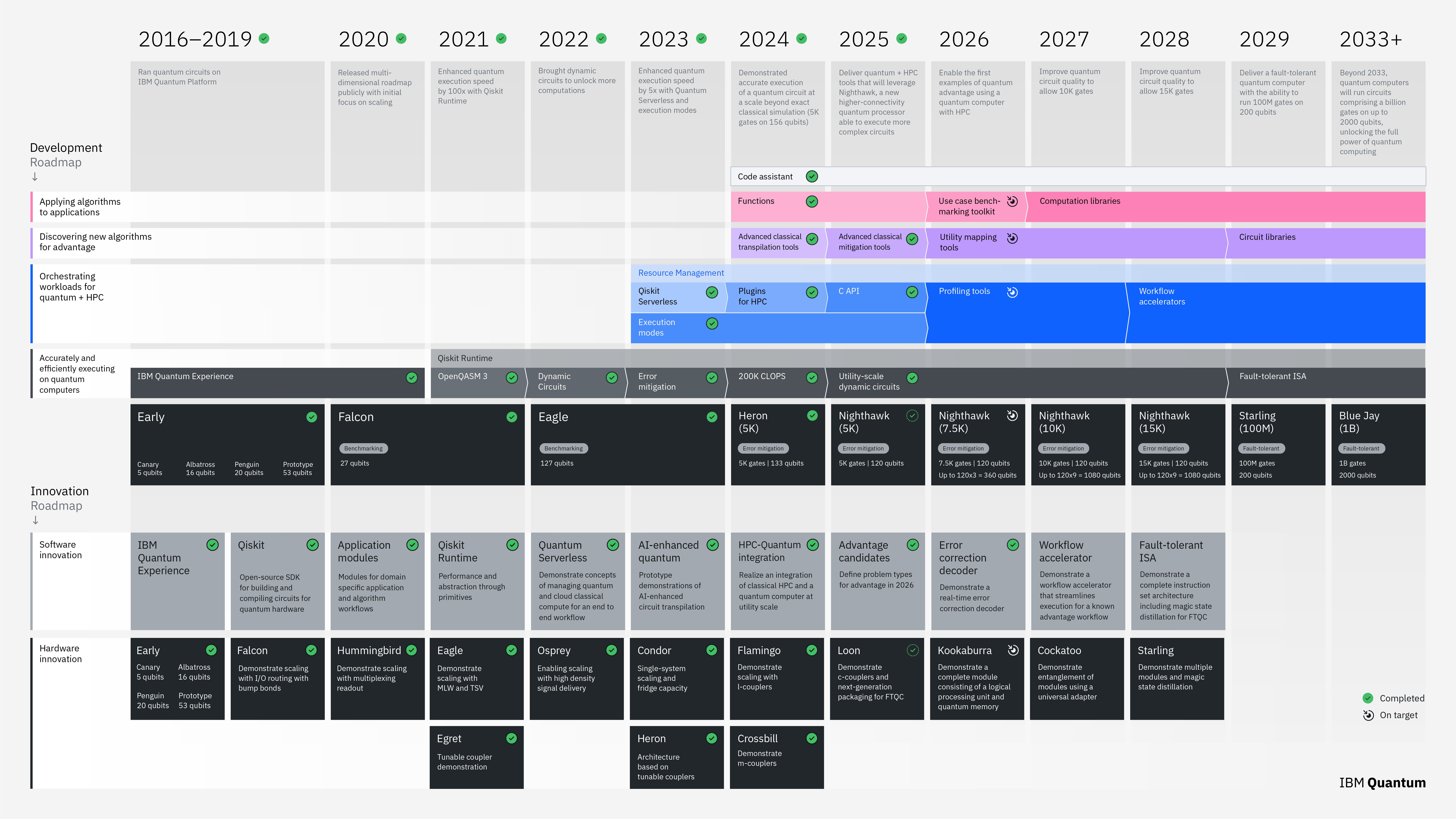

Updated 2025 IBM Quantum Roadmap

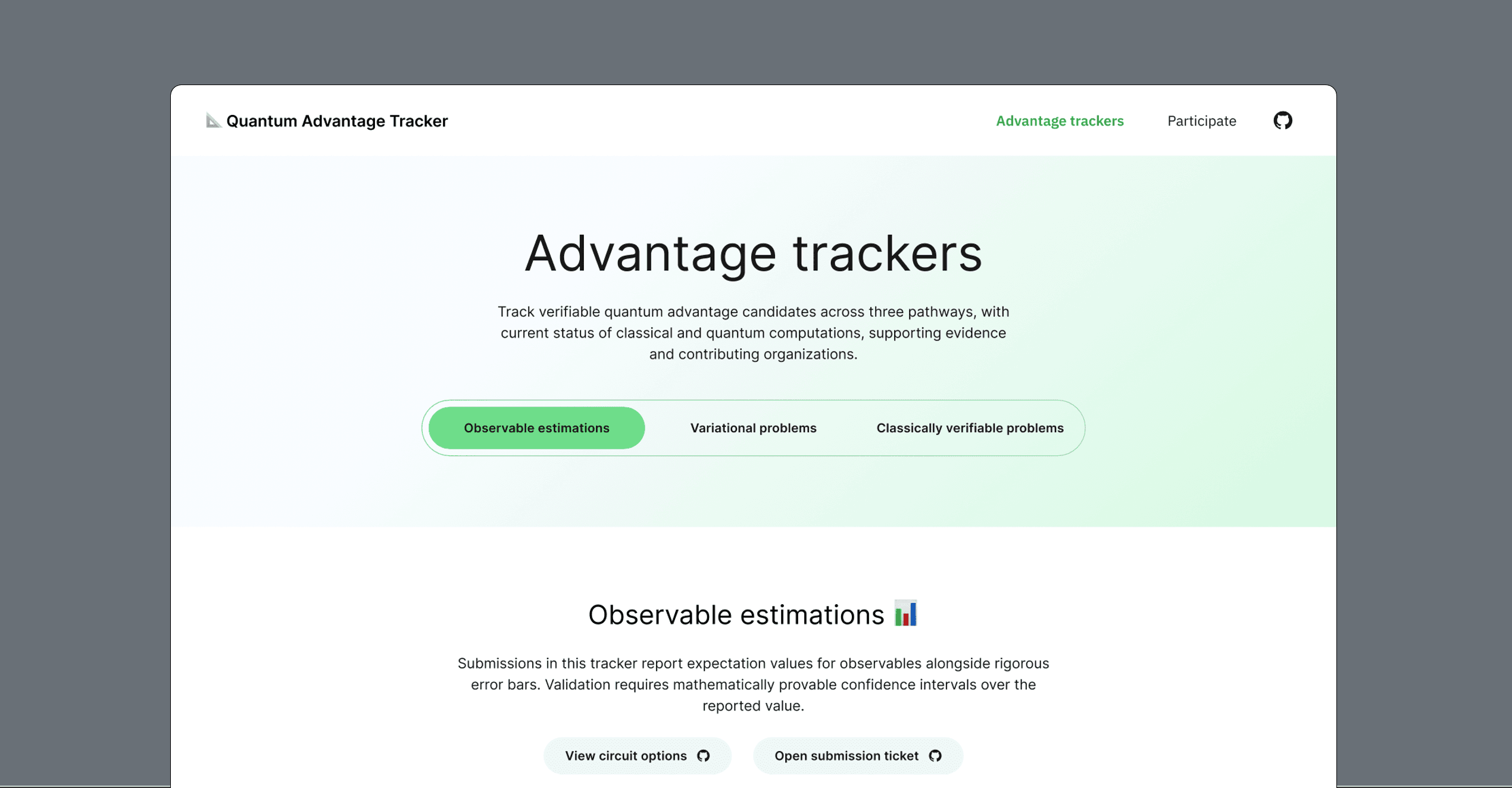

That's why IBM, Flatiron, BlueQubit, and Algorithmiq have contributed to an open, community-led advantage tracker. The tracker allows users to systematically monitor and evaluate promising candidates of quantum advantage—and how these candidates stack up against the leading classical methods.Learn more about the latest quantum advantage candidates with the new Quantum Advantage Tracker here.
New Quantum Advantage Tracker invites users to monitor and evaluate demonstrations of quantum advantage.

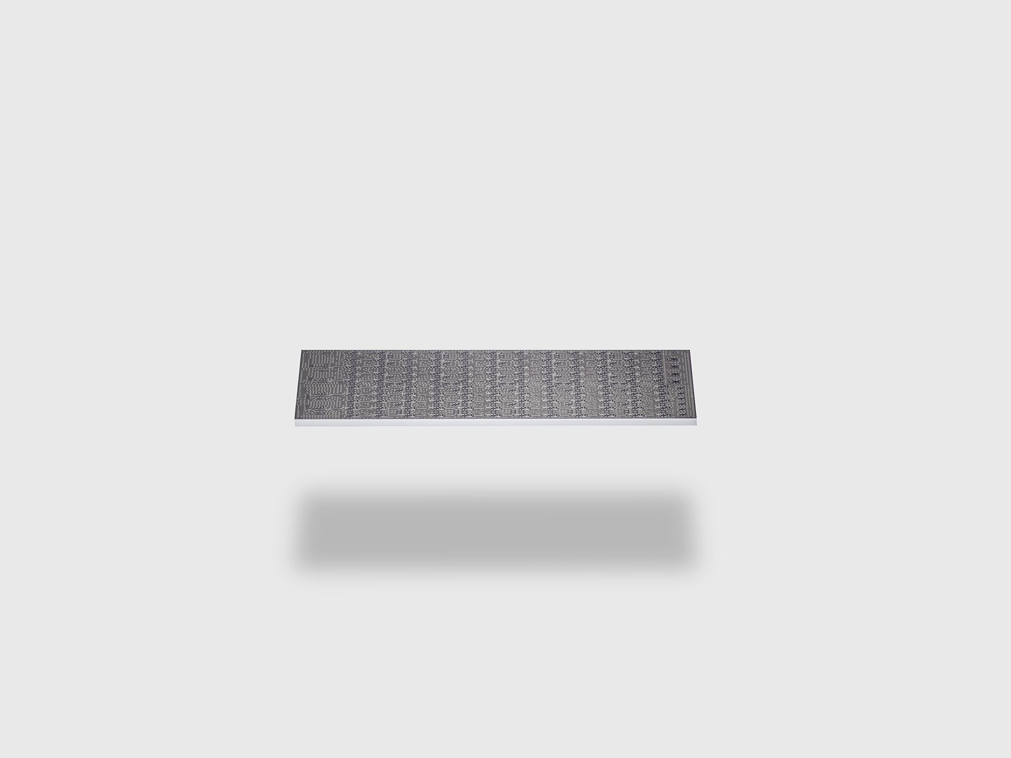

First, quantum advantage requires high-performing hardware. This year, we unveiled the 120-qubit IBM Quantum Nighthawk. Nighthawk is our first chip with a square qubit topology, increasing the number of couplers from Heron’s 176 to 218. This lets developers design circuits 30% more complex with fewer SWAP gates, allowing them to tackle bigger problems.
Nighthawk is designed to scale both modularly and in performance. We plan to improve the Nighthawk line of chips with revisions that can run circuits at 5,000, 7,500, 10,000, and ultimately 15,000 quantum gates. We promised a Nighthawk capable of running 5,000 gates by the end of 2025, and we project that we’ll be able to hit that milestone.Take a closer look at the new IBM Quantum Nighthawk here.
IBM Quantum Nighthawk's qubit plane includes 120 qubits arranged in a square lattice.

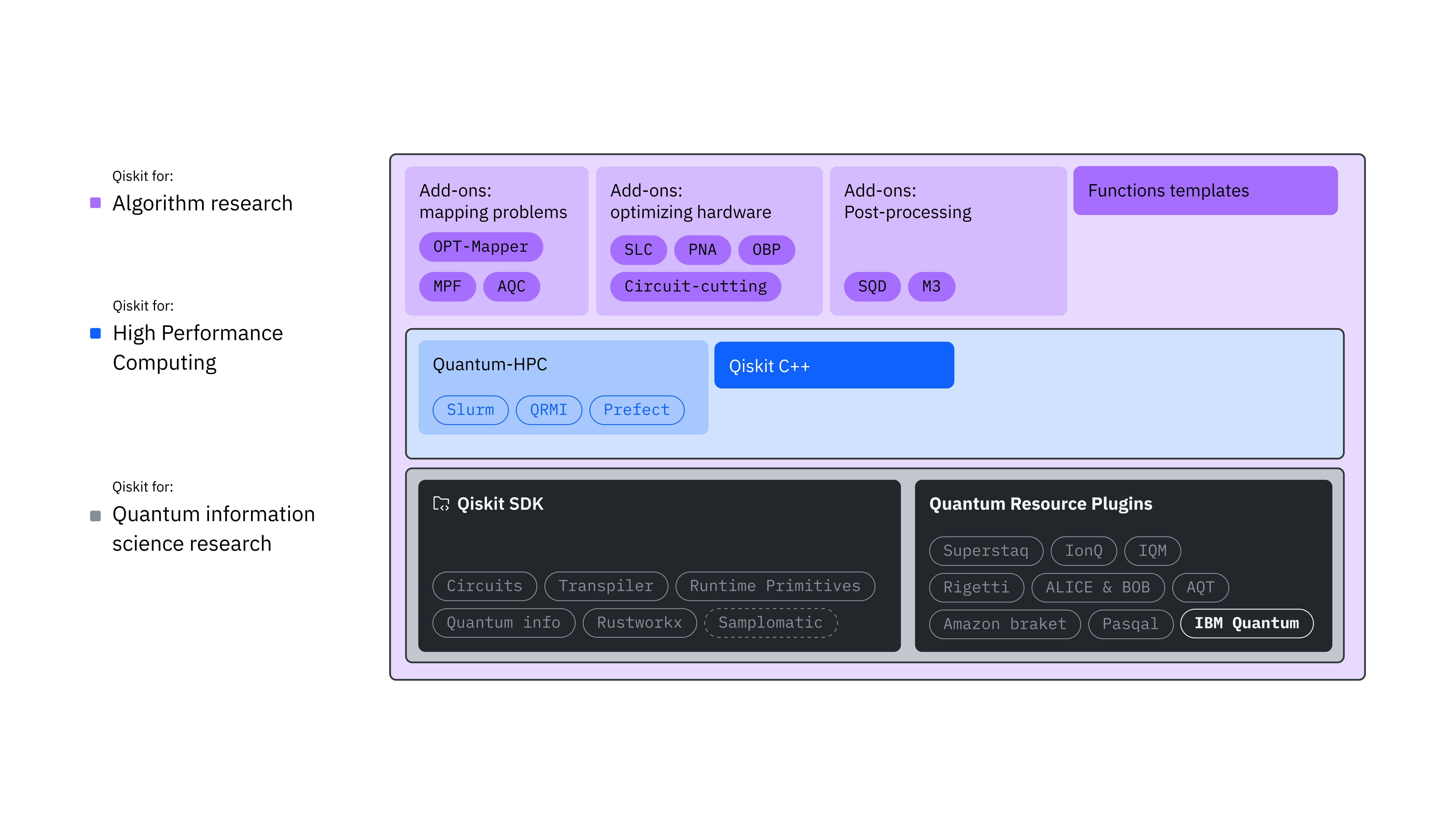

2025 Qiskit software stack
Meanwhile, finding and validating advantage requires a high level of control as developers build and optimize their circuits. Qiskit v2.1 enabled box annotations, where users can add flags to specific regions of a circuit. Now, the Samplomatic package lets you add customizations to those regions. Then, it transforms those customizations into a template plus a new object called the samplex, which provides semantics for circuit randomization. Users pass the circuit template and the samplex to the new executor primitive, altogether offering a far more efficient way to apply advanced and composable error mitigation techniques.Get started with the Samplomatic GitHub package here.
Annotations also enable circuit improvements—for example, building and running scalable dynamic circuits. Dynamic circuits incorporate classical operations in the middle of a circuit run, leveraging mid-circuit measurement and feeding information forward to make conditional changes to the rest of the circuit. Circuit annotations allow users to perform deferred timing and stretch operations, and in a demo shown at QDC, we used the stretch functionality to add dynamical decoupling to qubits that were idle during concurrent measurements and feedforward operations.
The result? We saw up to 25% more accurate results with a 58% reduction in ​two-qubit gates at the 100+ qubit scale. That includes using dynamic circuits over static circuits for a demo involving a 46-site Ising model simulation with 8 Trotter steps.​ In other words, we showed that it is now possible to run dynamic circuits at the utility scale—and that they provide tangible benefits over static circuits.Read our documentation for more on utility-scale dynamic circuits.
Further, samplomatic allows users more control and flexibility when running advanced classical error mitigation tools. Probabilistic error cancellation (PEC) is an error mitigation method that removes the bias from a noisy quantum circuit and provides noise-free expectation values. However, it comes with substantial sampling overhead. The improved control offered by samplomatic lets you add advanced classical error mitigation methods to circuits to decrease the sampling overhead of PEC by 100x.Add advanced classical error mitigation tools to your circuits with the new propagated noise absorption and shaded lightcones addons.
We’ve always said that quantum advantage will only come if quantum and classical work together. This year, we've seen numerous examples of how the global quantum community is expanding into HPC. However, scientific programmers work mainly in compiled languages like C++, and Qiskit was originally built in Python, an interpreted language.
That's why, with Qiskit v2.x, we introduced a C API leveraging a foreign function interface to enable bindings to any other programming language, either compiled or interpreted. Through the C API, Qiskit achieves deeper integration with HPC systems, allowing quantum-classical workloads to run efficiently wherever they are deployed. We recently built a C++ interface on top of the C API, highlighted at this year's QDC and on the IBM Quantum blog with a new quantum + HPC workflow demo.Explore Qiskit C++ and the new quantum + HPC workflow demo on GitHub, or read our C API documentation to learn more.
Together, the circuits and algorithms for advantage will ultimately power quantum application libraries—and we’ve committed to realize application libraries by 2027. At this year’s QDC, we showed state-of-the-art algorithms progress in the four key areas we expect to make up those libraries: Hamiltonian simulation, optimization, machine learning, and differential equations.
En route to that goal, we debuted Qiskit Functions a year early last year—and already, our partners at E.ON, Yonsei, and ColibriTD have published research with the help of functions from Q-CTRL and Qunova Computing. This year, Qunova Computing, Kipu Quantum, Colibri TD, and Global Data Quantum have contributed new Qiskit Functions to the catalog. We encourage you to check out the functions on IBM Quantum Platform.Explore the Qiskit Functions Catalog.

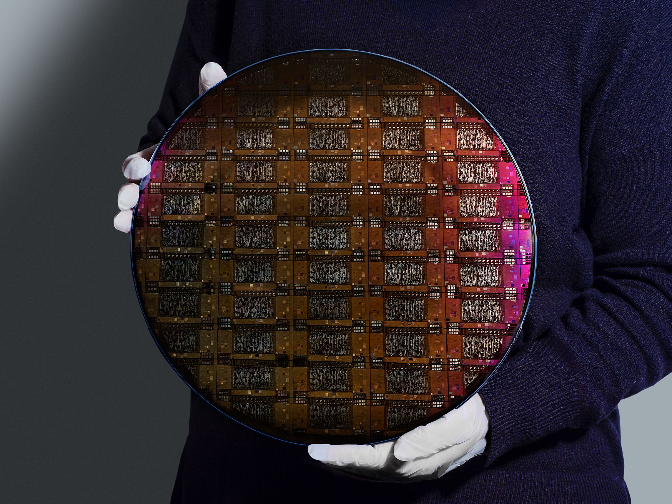

Driving our cycles of learning are new fabrication processes that let us create more chips, faster. This year, we revealed the process behind our chips—all of our chips begin on 300mm wafers at the state-of-the-art, always-on Albany NanoTech Complex, incorporating the latest advances in 300mm technology with our world-leading semiconductor and quantum expertise at IBM Research. These processes let us double the speed of R+D for our latest chips by slicing the wafer processing time in half—all while producing a chip ten times more complex than anything we have released prior.Learn more about why we’re using 300mm technology to fabricate quantum chips here.
IBM researcher holding a 300mm IBM Quantum Loon wafer (Credit: IBM)

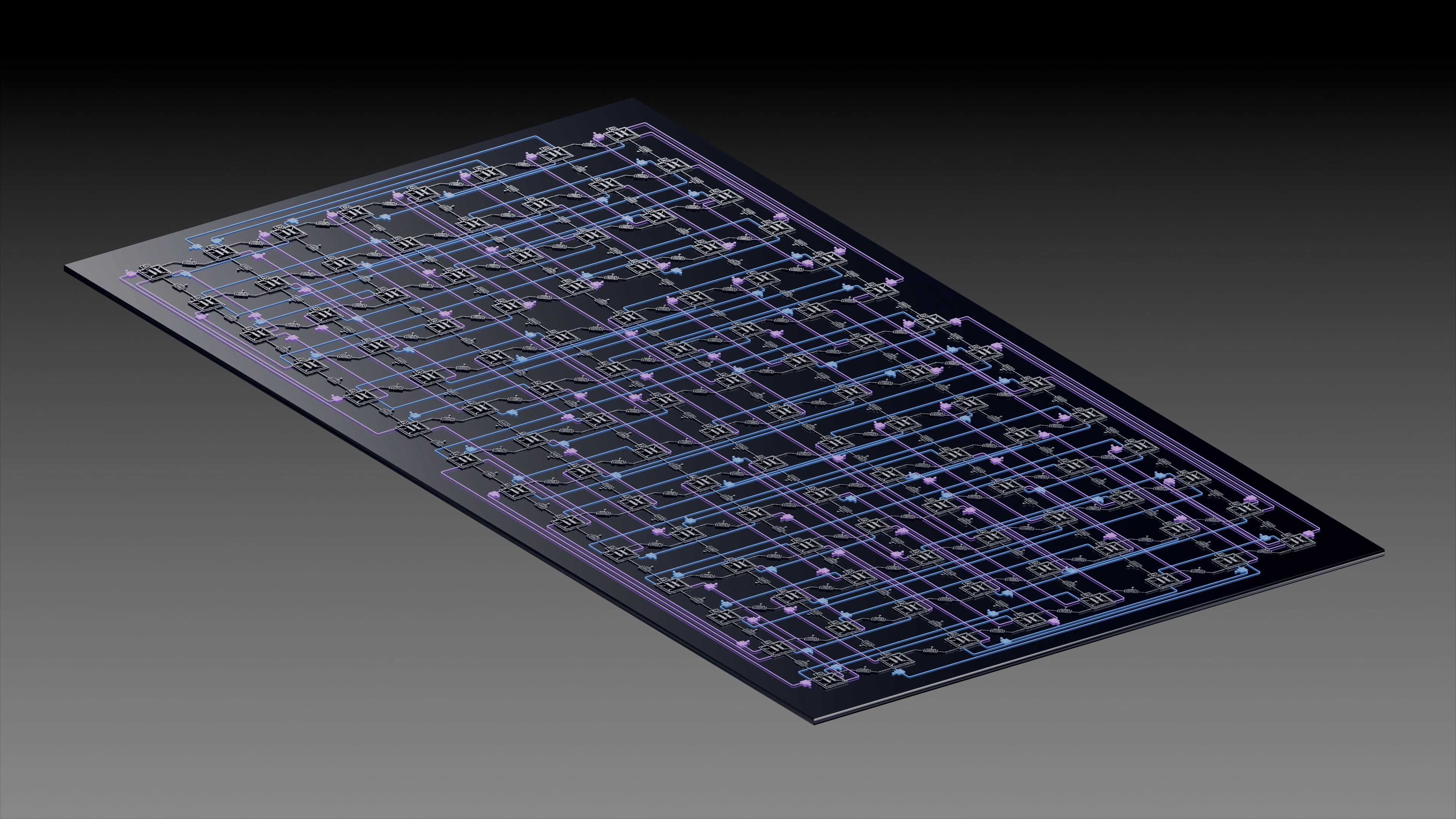

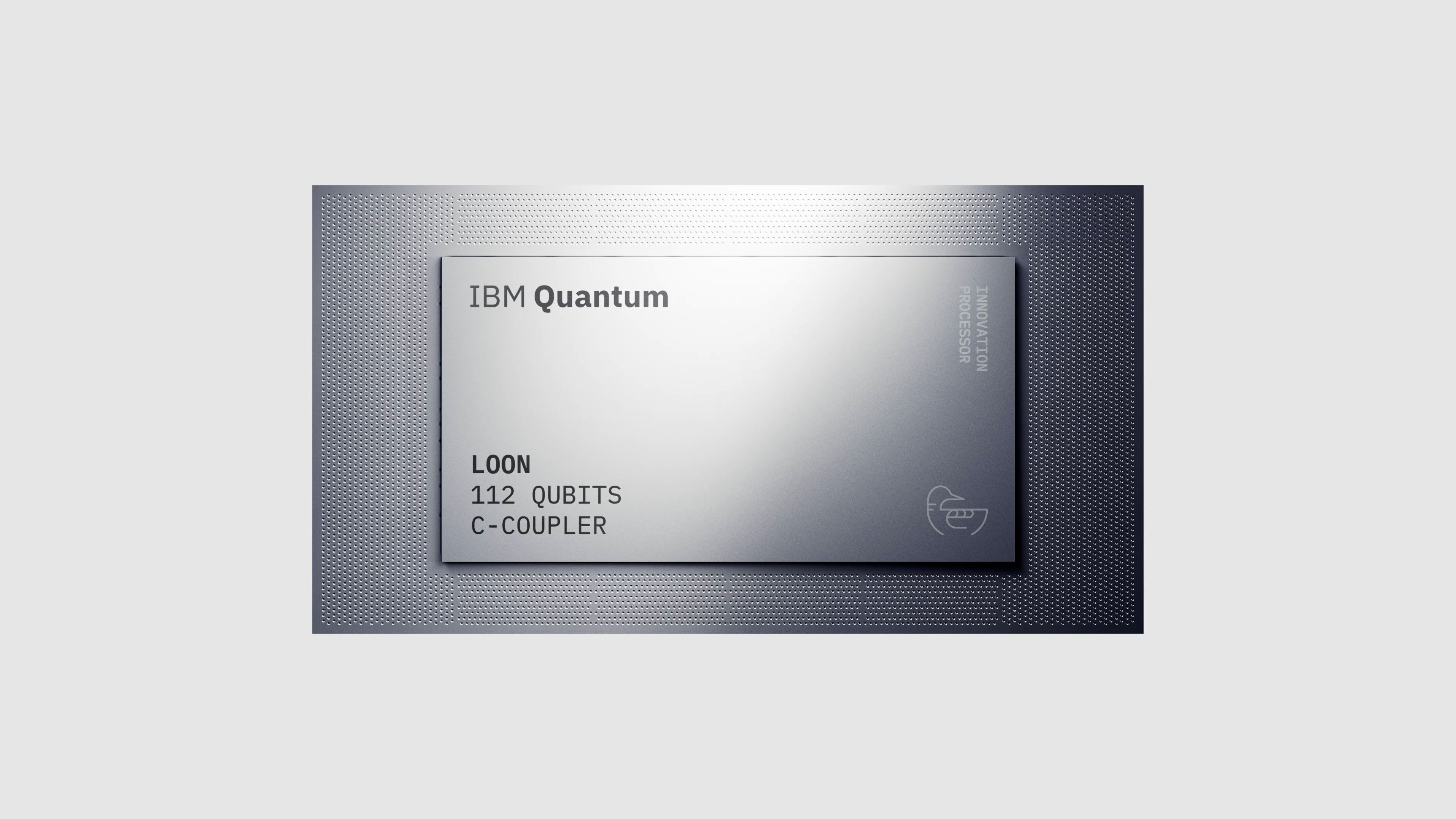

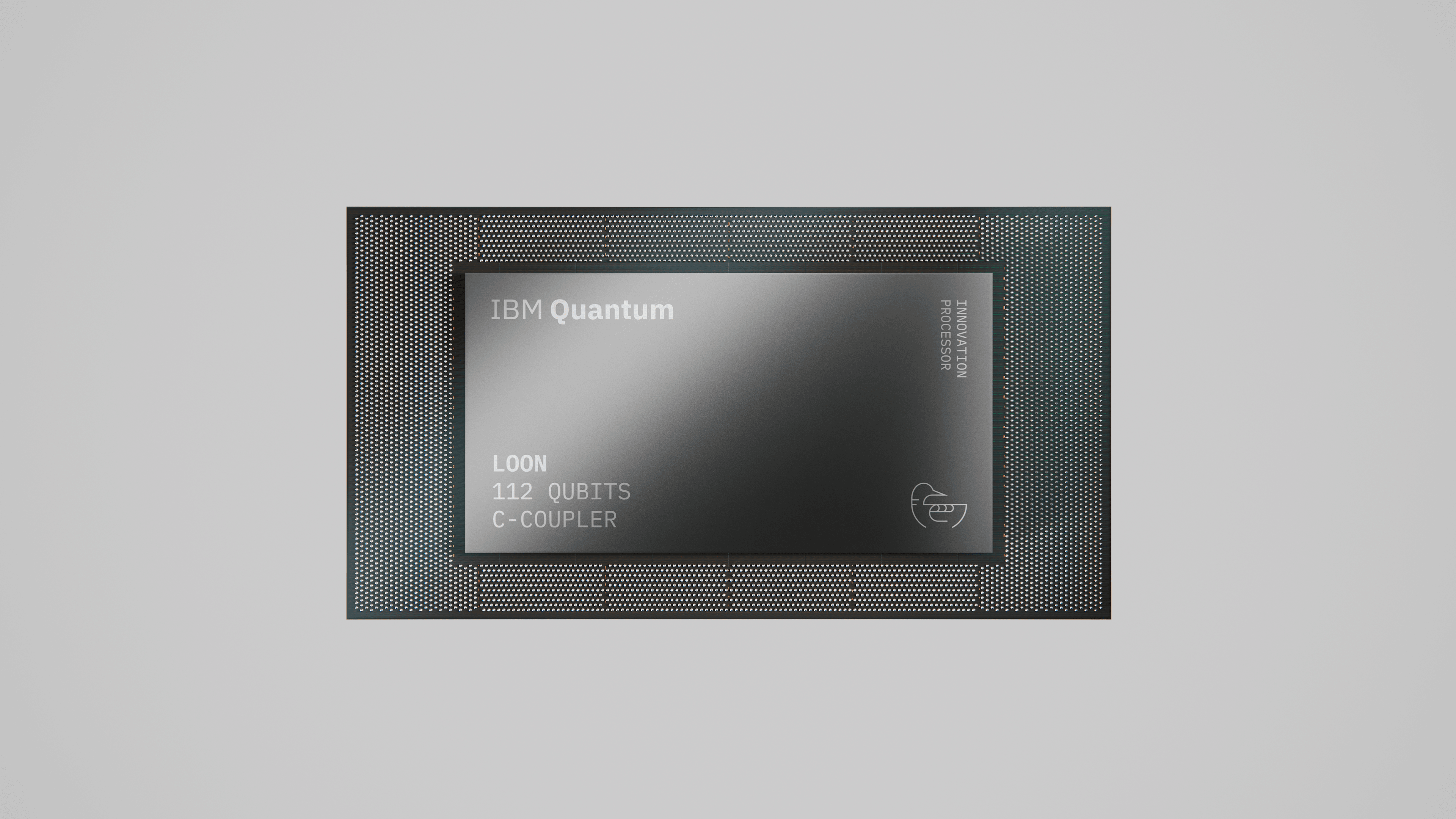

Those lessons set the stage for IBM Quantum Loon—a proof-of-concept processor that demonstrates many of the key components needed to implement our quantum low-density parity check (qLDPC) codes.
Loading
We've previously demonstrated our ability to achieve 6-way qubit connections, increase layers of routing on the chip surface, create physically longer couplers, and build reset gadgets that quickly reset the qubit to the ground state. With Loon, for the first time, we test all these features together, aided by new electronic design automation (EDA) to realize more complex architectures than ever before.
Today, Loon is almost out of fabrication, and will be assembled by the end of the year.
IBM Quantum Loon (Credit: IBM)
