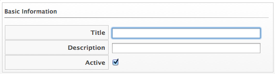

In the Basic Information area, type in a Title and Description. By default the widget will be active as soon as you create it. To make it inactive, uncheck the Active box.

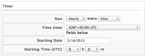

In the Timer area, click the Run drop down to specify how often you want the widget data to get updated. The options displayed will depend on which Run option you choose. Select Hourly, Daily, Weekly, or Monthly.
Select a Time Zone. Type or select a date to begin the schedule in Starting Date. Select a Starting Time based on a 24 hour clock in the selected time zone.

In the Basic Information area, type in a Name and Description for the schedule.

In the Timer area, click the Run drop down to specify how often you want the analysis to run. Your options after that will depend on which run option you choose.
Click Once to have the analysis run just one time.
Click Daily to run the analysis on a daily basis. You will be prompted to select how many days you want between each analysis.
Click Hourly to run the analysis hourly. You will be prompted to select how many hours you want between each analysis.
Select a Starting Time based on a 24 hour clock in the Infrastructure Automation appliance’s Time Zone.

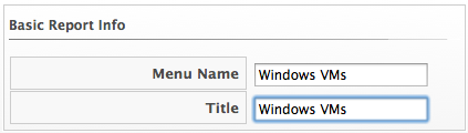

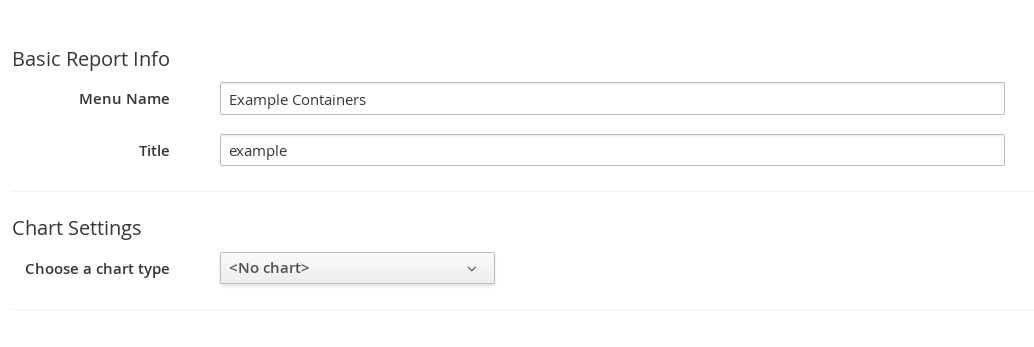

In the Columns tab, edit the Basic Report Info area.
Type a unique name in Menu Name for how you want the report described in the menu list.
Type the Title you want displayed on the report in title.

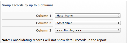

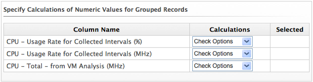

Click on the Consolidation tab to consolidate and aggregate data points into maximum, minimum, average, and total. Specifically, this would be useful for analyzing performance data over a specific period of time.
Note:
Please note that if you do this, you will not see individual records, but rather the calculation as a column header.
Select the columns to group by.
For each numeric field selected in the report, you can click the dropdown under Calculations. Check the calculations you want to use.

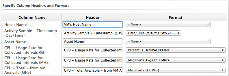

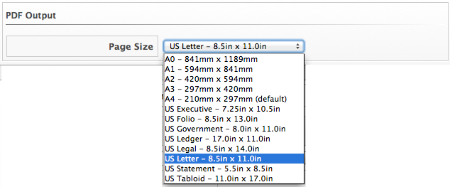

Click on the Formatting tab to set the size of paper for a PDF and column header format.
From the PDF Output area, select the page size from the dropdown.
From Specify Column Headers and Formats, type the text you want displayed for each field. For each numeric field, you can also set the numeric format.

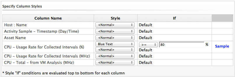

Click on the Styling tab to change the color of the text or the background for a row based on a condition.
Use Style to select the format for the value. You can choose to change the text color or the background.
Use If to create a conditional statement for the style.

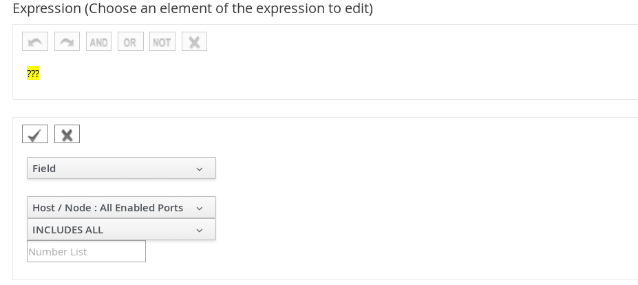

Click
in the appropriate area to use the
expression editor to choose the appropriate options for your
criteria. Based on what you choose, different options will show.

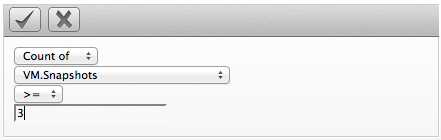

Click Field to create criteria based on field values.
Click Count of to create criteria based on the count of something, such as the number of snapshots for a virtual machine, or the number of virtual machines on a host.

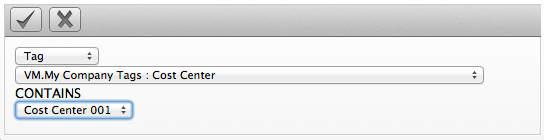

Click Tag to create criteria based on tags assigned to your resources. For example, you may want to check the power state of a virtual machine or see if it is tagged as production.
Click Registry to create criteria based on registry values. For example, you may want to check if DCOM is enabled on a Windows system. (Note that this applies only to Windows operating systems.)
Click Find to seek a particular value, and then check a
property. For example, finding the Admin account and checking
that it is enabled.
Click
(Commit Expression Element
Changes) to add the expression.

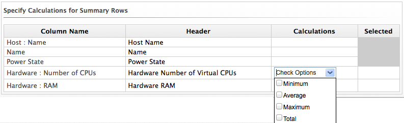

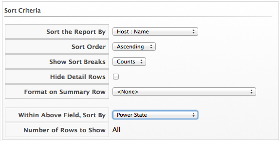

Click on the Summary tab to select sort order, sort type, groupings, and group calculations for the report. Summary groups rows of data based on the sort breaks. You can only sort by fields that display in the report.
Set the primary sort in Sort the Report by.
Set the next sorts in Within Above Field, Sort By.
Select the type of sort, ascending or descending, in Sort order.
In Show Sort breaks, select Yes to show the sort breaks, Counts to show sort breaks with the count, or No for no sort breaks.
For any numeric field, you can select to show minimum, average, maximum, and total in the sort break.
Click on the Charts tab to create a chart for the report. This is not required.
Use Choose a chart type to select a type of chart. Note that some charts may not produce the result you are looking for based on the types of fields in the report and its sort order.
If you only want to see the top values, select the number of top values from Top values to show.
If you want to see the total number of values that are not categorized or evaluated against others, check Sum ‘Other’ values.

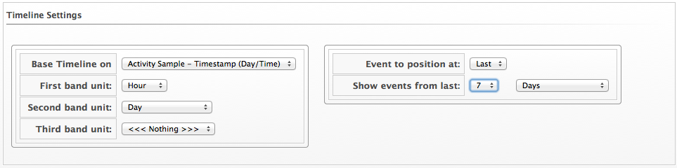

Click on the Timeline tab to select a timeline for the report. You must have a field of time or date format to use this feature.
Use Base Timeline on to select a column in date or time format for the report.
Select a unit of time for the first band in First band unit.
Select a unit of time for the second band in Second band unit.
Select a unit of time for the third band in Third band unit.
Select an Event to position at.
Select the range for the event to position from Show events from last.

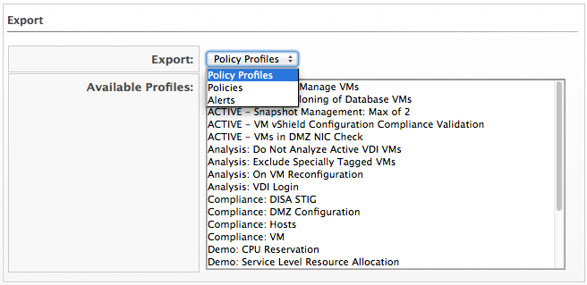

Reports are stored in the VMDB. Custom reports may be shared among VMDBs. Share your custom reports using the export and import features.
Navigate to Overview > Reports.
Select Custom Reports from the Import/Export accordion.
In the Export area, select the reports to export.
Click Export.

On the Columns tab, fill out the Basic Report Info area.
Type the Title to display on the report.

Click the Formatting tab to set the size of paper for a PDF and column header format.
From the PDF Output area, select the page size from the Page Size list.
From Specify Column Headers and Formats, type the text to display for each field. For each numeric field, you can also set the numeric format.

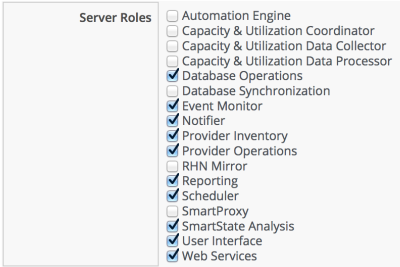

Click the Settings accordion, and select the Infrastructure Automation server.
From the Server Control tab, select the Notifier role.
Click Save.

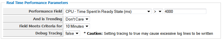

Real Time Performance alerts enables you to be notified immediately when a performance threshold has been met for a virtual machine, host, or cluster. Capacity and Utilization must be enabled for performance thresholds to be detected.
Navigate to Control > Explorer.
Click the Alert accordion, then click
(Configuration),
(Add a new
Alert).
In the Info area:
Type in a Description for the alert.
From Based On, select VM and Instance.
For What to Evaluate, select Real Time Performance.
In Notification Frequency, select how often you want to be notified if the performance threshold is reached.
Set the threshold in the Real Time Performance Parameters area.
From Performance Field, select the field to check and any other parameters required for that field.
In And is Trending, select Don’t Care if it does not matter how the performance metric is trending. Otherwise, choose from the possible trending options.
In Field Meets Criteria for, select the amount of time that the threshold requires to be met to trigger the alert.
Set Debug Tracing to true only when directed to do so by Red Hat Support. This provides an extremely detailed level of logging and can result in many more log lines being written.
After setting the parameters, you then select what you want the alert to do. You can send an email, create an SNMP Trap, or send a management event to start an automation process.
Click Add.

Expression alerts enables you to create a notification based on any possible criteria for clusters, datastores, hosts, and virtual machines. The following procedure creates an alert for when a host’s datastore has less than 5% free space.
Click on the Alerts accordion, then click
(Configuration),
(Add a new Alert).
In the Info area:
Type in a description for the alert.
From Based On, select Host/Node.
For What to Evaluate, select Expression (Custom).
In Notification Frequency, select how often you want to be notified if the expression is evaluated to true.
Use the expression editor to create your expression. This is the same expression editor used to create Conditions.
Click
(Commit expression element
changes) to accept the expression.
Click Add.

Alert profiles enable you to create groups of standard alerts. An alert profile can have as many alerts assigned as you need, and can be assigned to clusters, datastores, hosts, and virtual machines.
Note:
Each profile type under the Alert Profile accordion menu will have its own Alert Selections and subsequent Assignments choices.
Click on the Alert Profiles accordion, then click on the type of profile that you want to create.
Click
(Configuration),
(Add a new Profile).
In the Basic Information box, type in a unique Description for the alert profile.
Select the desired alerts from the Alert Selection area. Use the Ctrl key to select multiple alerts.
Click
to add the Alerts.
Type in any additional description in the Notes area.
Click Add.

If you have multiple VMDBs, you can export policies, policy profiles, or alerts from one to another. You can export and import for use with other Infrastructure Automation infrastructures.
Note:
The appliances you are exporting or importing data between must use the same Infrastructure Automation version.
Copy the file to import to a location that is accessible to your Infrastructure Automation console.
Navigate to Control > Import/Export.
Click Choose file to navigate to the location of the file.
Select the file, and then click Open from the file selection box.
Click Upload.
Verify that these are the policies or policy profiles that you want to import.
Click Commit.
From the Export dropdown, select policy profiles, policies, or alerts, depending on what you want to export.
From the Available Profiles or Available Policies or
Available Alerts list, select the items to export. Use the
Ctrl key to select multiple items to export into one file.
Click Export.
Follow the prompts in your browser to save the file.
