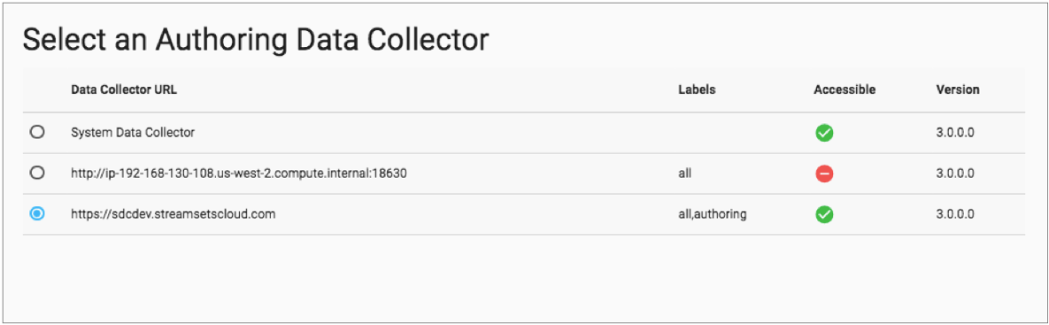

Note: Control Hub includes an optional system Data Collector for exploration and light development. Administrators can enable or disable the system Data Collector for use as the default authoring Data Collector in Control Hub. For more information about how the system Data Collector works as an authoring Data Collector, see System Data Collector.
For example, the following Select an Authoring Data Collector window displays the system Data Collector and two registered Data Collectors as choices for the authoring Data Collector. Notice how the second registered Data Collector listed in this image is not accessible and thus cannot be selected because it uses the HTTP protocol:

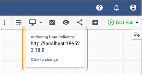

Click the Authoring icon () in the top right corner of the canvas to view which authoring engine is being used and to optionally change the selection.
For example, the following image shows the currently selected authoring Data Collector:

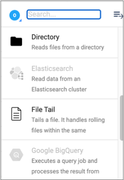

The stage library panel in the pipeline canvas displays all stages. Stages that are not installed on the selected authoring engine appear disabled, or greyed out. For example, the following stage library panel indicates that the Elasticsearch and Google BigQuery origins are not installed:
Stage library panel indicating that the Elasticsearch and Google BigQuery origins are not installed

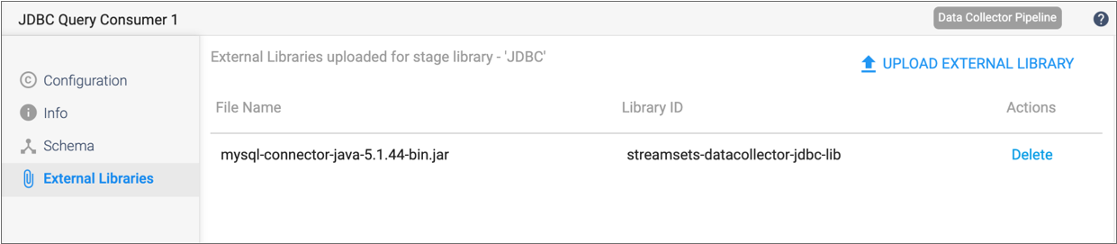

As you design Data Collector or Transformer pipelines, each stage requiring an external library displays the currently installed libraries in the External Libraries tab in the stage properties panel.
For example, the following image shows that a MySQL JDBC driver is installed for the JDBC stage library on the selected authoring Data Collector. As a result, this external library is available to the JDBC Query Consumer origin during pipeline design:
External library available to the JDBC Query Consumer origin during pipeline design

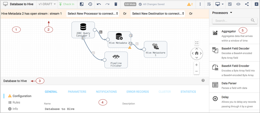

The following image shows the Pipeline Designer UI when you configure a pipeline:
Area/Icon Name Description
1 Pipeline Canvas Displays the pipeline. Use to configure the pipeline data flow.
2 Pipeline Creation Help Bar Offers lists of stages to help complete the pipeline.
You can use the help bar to connect a stage to an open node. You can also add a stage between linked stages by clicking the link.
3 Properties panel Displays the properties of the pipeline or selected stage when you configure a pipeline.
4 Selected stage pop-up menu Displays the icons for commands that you can apply to the selected stages.
5 Stage library panel List of available stages. Use to add stages to the pipeline. You can drag a stage to a location on the canvas or click a stage to add it to the end of the pipeline.
You can view all stages, stages by type, or stages by library. You can also search for a stage by name.
Stages that are not installed appear disabled, or greyed out. Click on a disabled stage to install the stage library that includes the stage.

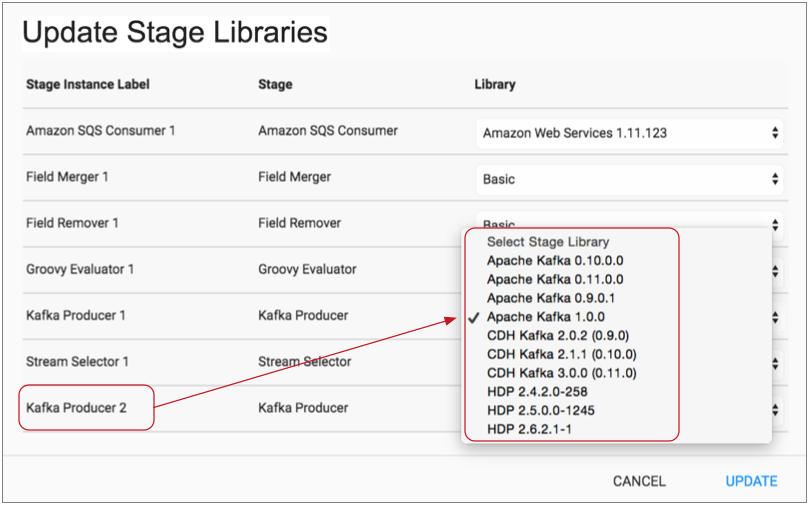

Update stage libraries for the pipeline
When editing a pipeline or pipeline fragment, you can use the Update Stage Libraries dialog box to update the stage libraries for multiple stages in the pipeline or fragment.
This allows you to update all necessary stage libraries at one time when you change the authoring engine for the pipeline or fragment. When preferred, you can also change stage libraries individually by editing each stage.
The stage libraries that display for each stage depend on the authoring engine selected for the pipeline or fragment. For example, if the authoring Data Collector has the MapR 6.0 and 6.1 stage libraries installed, then these are the stage libraries that display for a MapR FS destination or MapR FS File Metadata executor.
To update multiple stage libraries at one time, click the More icon (More icon), then select Update Stage Libraries.
The Update Stage Libraries dialog box displays the stage name and type for each stage in the pipeline or fragment. On the right is the corresponding list of stage libraries for the stage that are available on the authoring engine.
Update the stage libraries as needed, then click Update to save your changes.
Updating the stage libraries for each stage

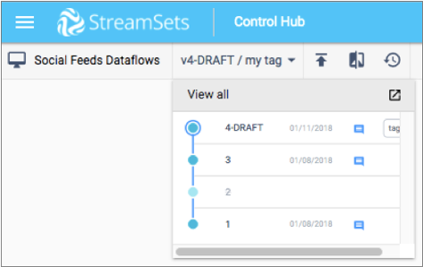

Work with versions
When you have multiple versions of a pipeline or pipeline fragment, Control Hub indicates the version of the pipeline or fragment that you are viewing. You can click the pipeline or fragment version to select a different version to view, as follows:
Pipeline or fragment version selection
For more information about working with versions, see Version History.

If needed, you can change the authoring engine for the pipeline using the Authoring icon: .

  5. Select an available authoring Data Collector or Transformer, and then click Create.
    If you use the system Data Collector, you cannot use data preview to help develop the fragment.
    A blank canvas displays.
If needed, you can change the authoring engine for the fragment using the Authoring icon: .
