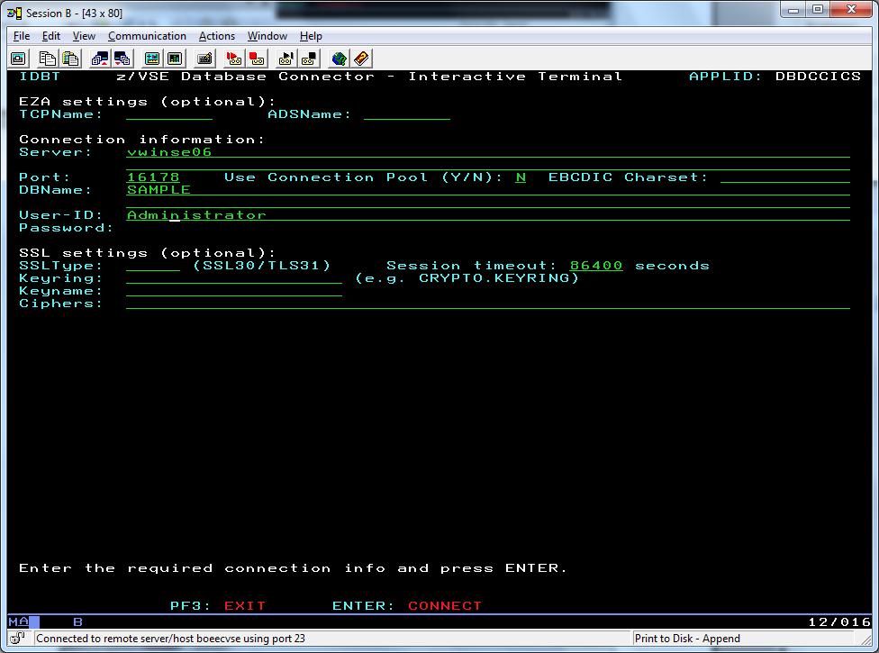

The Interactive Query Tool displays 3270 based screens. The initial screen shown in Figure 1 shows you how to specify to which DBCliServer and which database alias you want to connect. Enter the required input and press enter.
Figure 1. Interactive Query Tool Initial Screen
An explanation of this figure is provided in the surrounding text.
