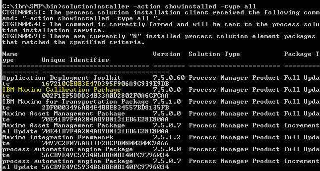

2. Using the <install_home>\bin>solutioninstaller -action showinstalled -type all

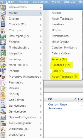

Okay, so now you made sure that you have Maximo Calibration 7.5 in your Maximo folder structure and in your database. WHY IS THERE NO APPLICATION THAT HAS "(Cal)" BESIDE IT LIKE FOR SOME INDUSTRY SOLUTIONS LIKE TRANSPORTATION? An example of an application for Transportation is the below application:

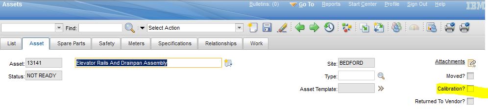

To answer that question, there would be no application that has "(Cal)" in it because it is already embedded in the code and the Calibration installation just enabled it. To learn that the application has Calibration in it, you will see a Calibration Checkbox just like in the picture below:
