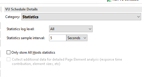

VU Schedule Details - Statistics
Gathering statistics is a vital component of performance test reports. The gathering of them is also a frequent contributor to product performance issues and, sometimes, apparent "hangs" at the end of test runs.
As a schedule runs, it periodically gathers samples. The playback engine collects samples in bit buckets. For the sake of argument, consider a bit bucket to be a file. To that end, every sample bit bucket consumes system resources and network bandwidth when it is transmitted back to the performance tester workbench at the end of a run.
The default sample interval is 5 seconds.  As the expected execution time of a schedule increases, the number of bit buckets increases. If that number gets too high, it can have noticeable, even fatal effect on a schedule run.
It is recommended that testers consider the sample interval with every schedule created.  Ideally, settle upon a sample interval that generates *approximately* 100 bit buckets.

That schedule will run for 7200 seconds (60 seconds in an minute x 60 minutes in an hour x 2 hours).
With a 5 second sample interval, it will generate 1440 bit buckets.
This can be a burden on the system.
How do we to approximately 100 bit buckets, instead of 1440?
7200 seconds/100 samples = 72 seconds per sample
This is where "approximately" comes into play. 72 seconds is not a time interval that feels natural; no one thinks in 72-second intervals. A minute, though, that is a commonly understood interval.
 * 2 hour schedule
 * 60 second sample interval
That will generate 120 bit buckets (7200 seconds/60 seconds per sample =  120 samples).
120 is a far cry smaller than 1440.
