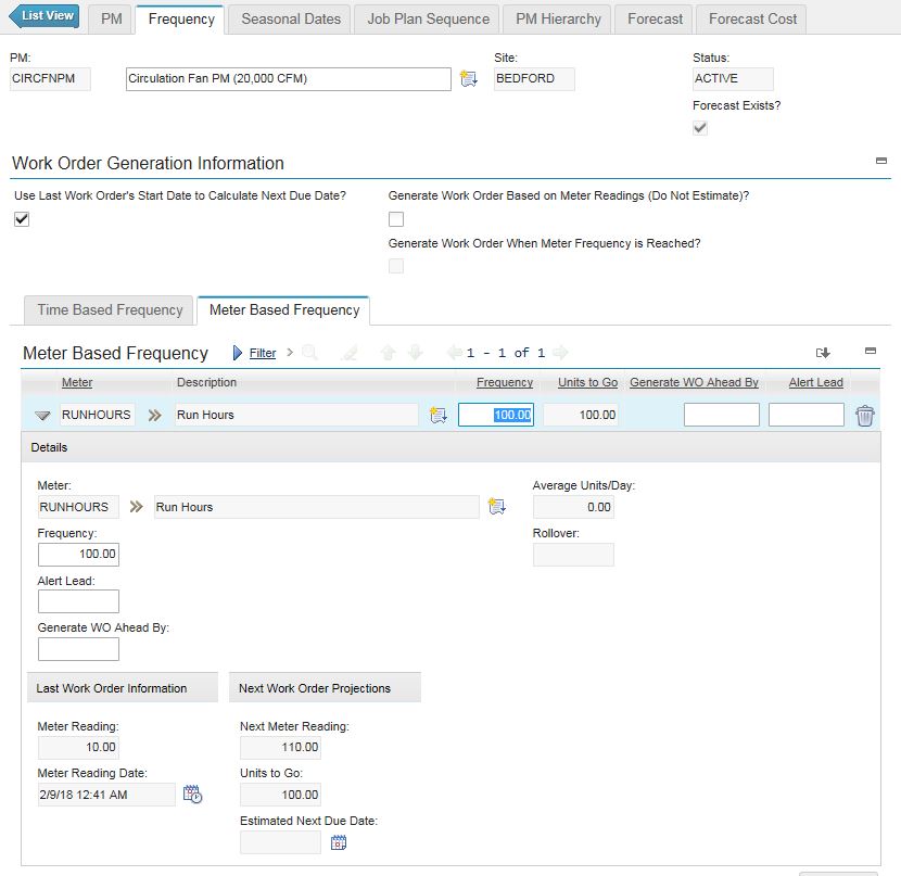

- If a PM has both a time-based frequency and a meter-based frequency associated to it, then the Work Orders will generate upon whichever of these frequency intervals is met first. In
other words, if a PM has a time-based frequency of 3O days as well as a meter based frequency of 100 hours, then a Work Order will get generated at either 30 days, or at 100 hours,
whichever happens first.

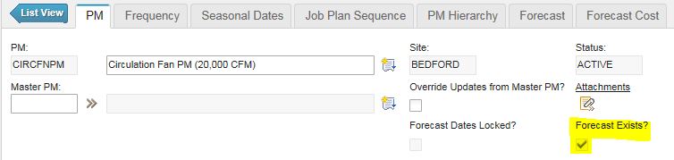

*In the above example, the Forecast Date will overrule either frequency, and the Work Order will generate upon the Forecast Date. (note that the Forecast Exists checkbox is selected):
