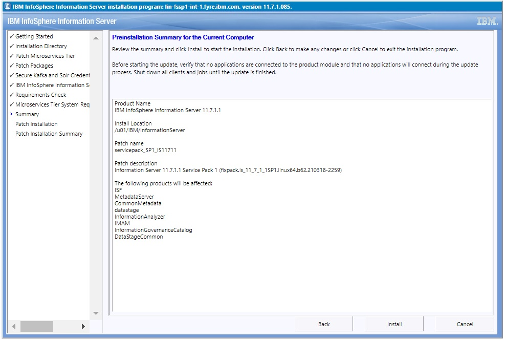

4.1.13) Review the Preinstallation Summary and click the Install button to start the installation.
image 8901
