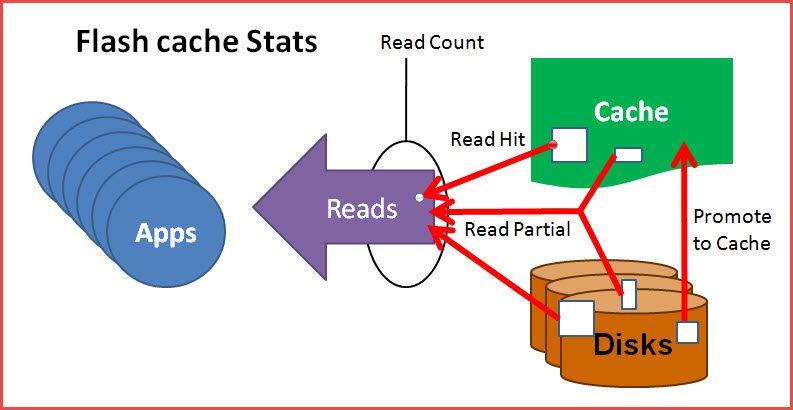

Explanation of fields with "cache_mgt monitor get":
Read Count The total number of read operations that were issued to the target device.
It is the count for all applications that issued read commands that were sent to the SAN
device or to cache. This number has no relation to the size of the requests.
It is the count of separate read requests.
Read Hit Count The total number of read operations that were issued to the target device
that are full cache read hits. The read hit count is the total number of instances in which
a read request is satisfied entirely by the cache. This number has no relation to the size of the requests.
It is the actual count of separate read hit requests, and the value is a portion of the "Read Count."
Partial Read Hit Count The total number of read operations that were issued, which are
partial cache read hits. The partial read hit count is the total number of instances in
which a read request had part, but not all, of the data requested in the cache.
The remainder of the data not available in cache must be acquired from the SAN device.
This number has no relation to the size of the requests. It is the actual count of separate
read requests, and the value is a portion of the "Read Count."
Promote Read Count
This counter is the total number of read commands that were issued to the SAN as part of the promote into cache. This number is not tied to the number of promotes because a 1 MB read promote might be divided into multiple read requests, if the maximum transfer size to the SAN disk is less than the 1 MB fragment size.
Read Bytes Xfer
The total number of bytes that were read for the target device. It is the total bytes transferred for read commands that were issued from the applications into the driver, and represents the total byte count of read hits, partial read hits, and read misses.
Read Hit Bytes Xfer
The total number of bytes that were read through the target device that were full cache read hits.
Partial Read Hit Bytes Xfer
The total number of bytes that were read through the target device that were partial cache read hits.
Promote Read Bytes Xfer
This statistic is the total number of bytes that were read from the SAN for promotes.
Write Count
The total number of write operations that were issued to the target device. This number has no relation to the size of the requests. It is the actual count of separate write requests.
Write bytes Xfer
The total number of bytes that were written to the target device. It is the total number of bytes transferred from all write commands that were issued from the applications into the device.
This diagram might be helpful:
![stats](/support/pages/system/files/inline-images/FlashCacheStats.jpg)
