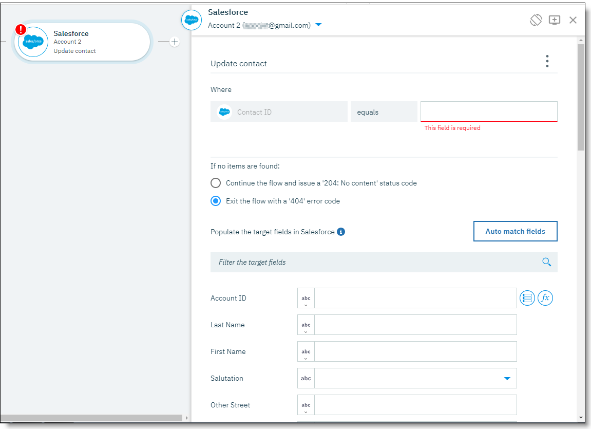

When you add an update action to a flow, you must first indicate which item or record you want to update by specifying its ID as a text value or by mapping to a field from a previous node.
Figure 1. Sample fields for an update action

After specifying a value for the filter condition, indicate what should happen if App Connect finds no item to update:
  • Continue processing any remaining nodes in the flow, but issue a response code of 204: No content
  • Choose to exit the flow at that point and issue a '404' error.
Finally, complete the fields that you want to update in the target application. Leave a field blank if you don't want to update its value. The values that you specify will overwrite existing values in the target app.
