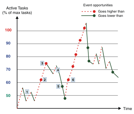

To avoid large numbers of events being emitted, events are emitted only when the number of active tasks crosses a new threshold boundary. For example, events are emitted during transaction attach when the number of active tasks exceeds a threshold and the previous goes higher than event was when the next lowest threshold was crossed. Events are emitted during transaction detach when the number of active tasks falls below a threshold and previously goes lower than event was when the next highest threshold was crossed. Figure 1 shows such examples.
Figure 1. Event emission opportunities
An example line graph of the values of MAXTASKS over elapsed time. Points on the graph indicate where the value of MAXTASKS crosses a threshold boundary and creates an event emission opportunity.
 1  No events are emitted when the number of active tasks exceeds the 50% threshold. Events are emitted during transaction attach only when the number of active tasks crosses one of the 60%, 70%, 80%, 90%, or 100% thresholds. No events are emitted when the number of active tasks falls below the 50% threshold, because the number of active tasks has not been above the 60% threshold since the last goes below 50% event.
 2  An event is emitted because the number of active tasks exceeds the 60% threshold for the first time since the previous goes above 50% event.
 3  An event is emitted because the number of active tasks exceeds the 70% threshold for the first time since the previous goes above 60% event.
 4  No events are emitted when the number of active tasks oscillates around the 70% threshold because the number of active tasks does not cross a threshold boundary to either exceed the 80% threshold or drop below the 60% threshold.
 5  An event is emitted because the number of active tasks drops below the 60% threshold for the first time since the previous goes below 70% event.
 6  A series of events are emitted when the number of active tasks progressively exceeds the 60%, 70%, 80%, 90%, and 100% thresholds.
