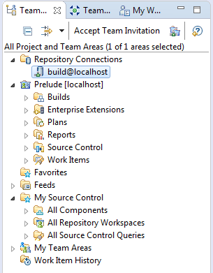

Setting up an Eclipse workspace for the build team member
In this tutorial, the build team member that you created in an earlier lesson is the dedicated build user. Set up and configure a new Eclipse workspace for the build team member.
About this task
Procedure
- Switch to a new Eclipse workspace.
- Create a repository connection.
- Connect to the Prelude project area.
