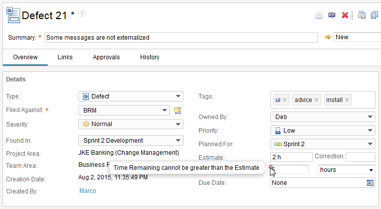

- Invalid Estimate Check: This check displays a warning if
you attempt to change the Time Remaining value to a number
that is more than the Estimate value.Note: If you use Time Spent for your project (rather than Time Remaining), this check does not happen.

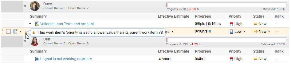

- Priority Mismatch: If the priority of a parent work item
is not the same as its child work items, a warning is displayed. Note: You must add the Priority attribute in the Column Display tab for this plan check to display.

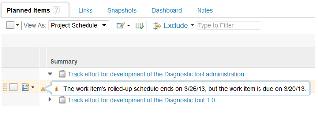

- Cross-Project Planning Problems Check: This option displays
warning messages when any of the following conditions are met:
- The rolled-up schedule for a work item on the plan exceeds the end date of the iteration that the plan is associated with.
- The
planned for
date of a plan item exceeds the plan's iteration end date - The rolled-up schedule for a work item on the plan exceeds the due date that is specified on the work item.

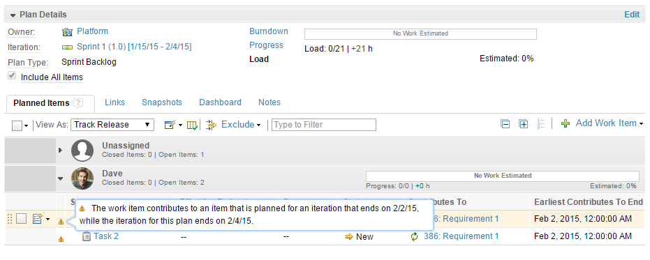

- Contributes To Planning Problems Check: Use this check
in a plan that contributes to cross-project plan items. The check
displays a warning message if a contributing work item is planned
for an iteration that ends later than the iteration of the work item
that it contributes to. Note: To track the early release end dates that the work item contributes to, you can add the Earliest Contributes To End Date attribute in the Column Display tab. A
contributes to
link that has a target work item on a different server is ignored when computing the value of the Earliest Contributes To column or when performing the Contributes to Planning Problems Check.
