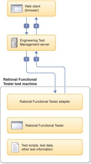

Managing automated tests that are local to a test machine
To use the adapters to run automated tests that are local to a test machine, these requirements must be met:
  • The Engineering Test Management web client and server must be running.
  • Except in the case of IBM Security AppScan Tester Edition, the adapter must be installed and running on the same machine as its corresponding test tool.
  • Test scripts and other test artifacts must be on the local test machine where you are going to run the tests.
The following diagram shows a request to run an automated test when the test resources are already on a test machine. The process is the same for the other test tools, except for IBM Security AppScan Tester Edition.
Table 1.
Process Flow Explanation
Integration between Engineering Test Management, the Functional Test adapter, and the test machine
  1. You request the Functional Test adapter to run an automated functional test that is stored on a local test machine.
  2. The Functional Test adapter receives the request and initiates a test run on the test machine.
  3. The test runs on the test machine, and the adapter sends the results back to the Engineering Test Management server.
  4. You can view the test run and its results in the web client.
For more information, see the related help topic about creating a reference to an automated test script on a local test machine.

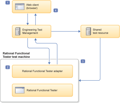

Managing automated tests that are stored at a shared location
In Engineering Test Management, you can specify that test resources must be copied from a shared location to a local test machine where the test is run. When you create the test script, you specify the shared location where the test resources are stored. When you run the test, you specify the test machine where the test is to run. The test resources are copied to that machine. Finally, the adapter on that machine runs the test by using a copy of the test resources.
Note: Before you can use shared test resources, an administrator must make the resources available to Engineering Test Management. After the shared resource are available, team members can create test scripts that reference that resource.
The following diagram shows a user request to run an automated test that is stored at a shared network location:
Table 2.
Integration with an automated test that is stored on a shared test resource
  1. You request to run an automated functional test that is stored at a shared network location.
  2. The Functional Test adapter receives the request and copies the test from the shared location to the functional test machine.
