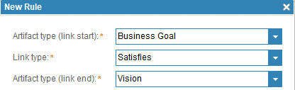

In the following example, a single rule specifies that a Business Goal artifact has a Satisfies link to a Vision artifact:
Because this is the only rule in the project, no other links are allowed. If you are creating a link from a Vision artifact or Business Goal artifact, only the Satisfies and Satisfied By link types are available. No other link types are available from any other artifacts.

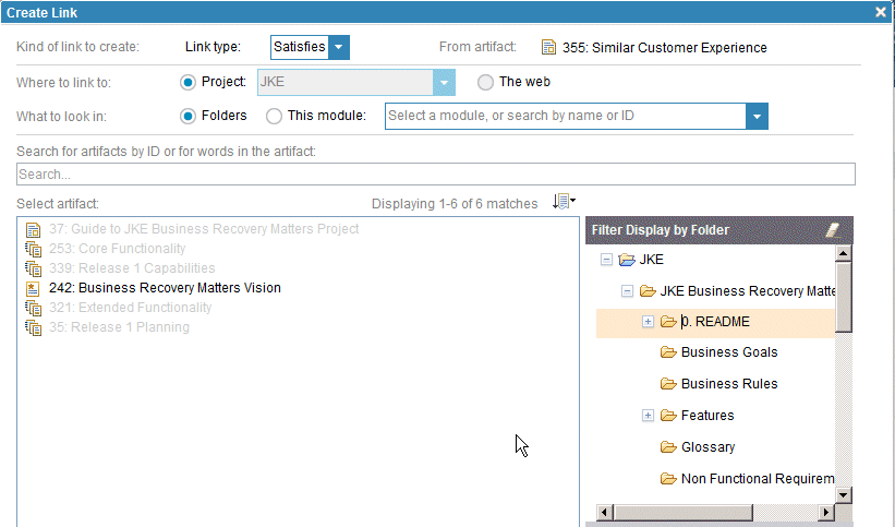

In addition, in the Create Link window, you can select only those artifact types that are allowed based on the initial artifact type and the selected link type, as shown in the following image:
In the Create Link window, you can also select certain components and artifact types based on defined link constraints, including the artifact types that contain a cross-component artifact type.
