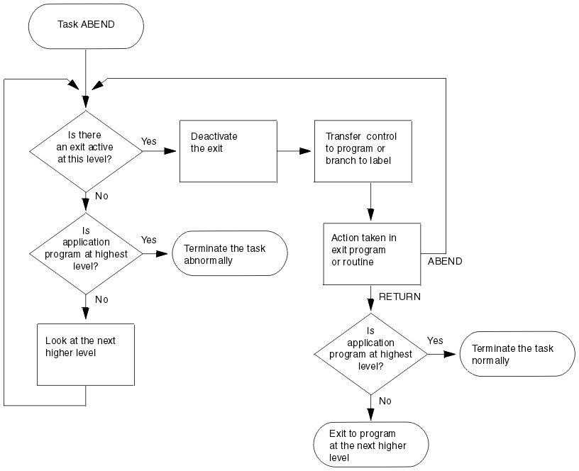

Retrying operations
If an abend occurs during the invocation of a CICS® service, issuing a further request for the same service can cause unpredictable results. Because the reinitialization of pointers and work areas, and the freeing of storage areas in the exit routine, might not have been completed.
You should not try to recover from ATNI or ATND abends by attempting further I/O operations. Either of these abends results in a TERMERR condition, requiring the session to be terminated in all cases. You should not try to issue terminal control commands while recovering from an AZCT abend, or an AZIG abend, as CICS has not fully cleaned up from the RTIMOUT, and an indefinite wait can occur.
If intersystem communication is being used, an abend in the remote system might cause a branch to the specified program or label, but subsequent requests to use the same resource in the remote system might fail. If an abend occurs as a result of a failure in the connection to the remote system, subsequent requests to use any resources in the remote system might fail.
