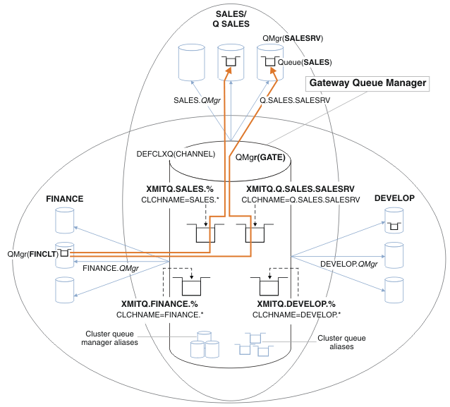

In this task you apply the steps to plan multiple cluster transmission queues to three overlapping clusters. The requirements are to separate messages flows to one cluster queue, from all other message flows, and to store messages for different clusters on different cluster transmission queues.
About this task
The steps in this task show how to apply the procedure in Clustering: Planning how to configure cluster transmission queues and arrive at the configuration shown in Figure 1. It is an example of three overlapping clusters, with a gateway queue manager, that is configured with separate cluster transmission queues. The MQSC commands to define the clusters are described in Creating the example clusters.
For the example, there are two requirements. One is to separate the message flow from the gateway queue manager to the sales application that logs sales. The second is to query how many messages are waiting to be sent to different departmental areas at any point in time. The SALES, FINANCE, and DEVELOP clusters are already defined. Cluster messages are currently forwarded from SYSTEM.CLUSTER.TRANSMIT.QUEUE.
The steps to modify the clusters are as follows. For the definitions, see Changes to isolate the sales queue in a new cluster and separate the gateway cluster transmission queues.

Switch to the new configuration on the gateway queue manager.
The switch is triggered by starting the new channels, and restarting the channels that are now associated with different transmission queues. Alternatively, you can stop and start the gateway queue manager.
- Stop the following channels on the gateway queue manager:
SALES. Qmgr DEVELOP. Qmgr FINANCE. Qmgr - Start the following channels on the gateway queue manager:
SALES. Qmgr DEVELOP. Qmgr FINANCE. Qmgr Q.SALES.SAVESRV
When the switch is complete, remove the SALES queue from the SALES cluster; see Figure 2.
