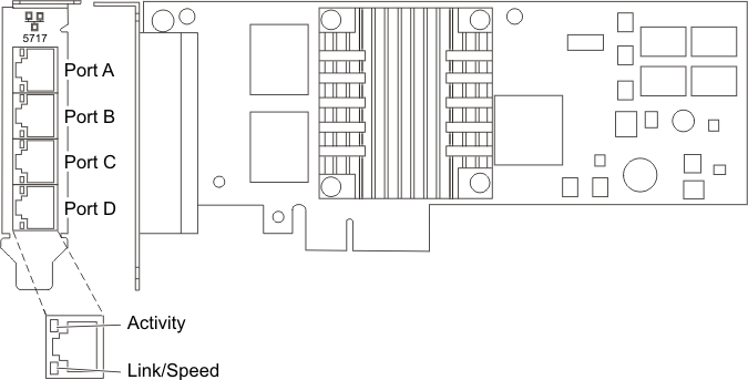

Adapter LED states
The LEDs on the adapter provide information about the adapter's operation status. The LEDs are visible through the adapter's mounting bracket. 4-Port 10/100/1000 Base-TX PCIe Adapter shows the location of the LEDs. Table 1 describes the different LED states and what those states indicate.
| LED | Light | Description |
| Activity/link | Green | Active link |
| Off | No link The absence of a link can indicate a defective cable, defective connector, or a configuration mismatch. |
| Blinking | Data activity | |
| Speed | Off | 10 Mbps |
| Green | 100 Mbps | |
| Orange | 1000 Mbps |
