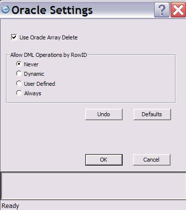

Oracle
For an Oracle database, you can set options to control archive, extract and delete processing. Click the Oracle button to display the Oracle Settings panel:
- Use Oracle Array Delete
Select Use Oracle Array Delete to use the Oracle array delete feature during a delete process.
Note: If your site audits delete processing, be aware that Array Delete may report rows as being successfully deleted that do not exist in the database and, therefore, were not actually deleted by the process.The Oracle array delete feature is performed during a delete process only when the following are true:
- Compare Row Contents is not selected in the Delete Request Editor.
- Both the table in the source file and database have a unique primary key.
- The table has no file attachments to be deleted.
- Allow DML Operations by RowID
- Controls whether Optim extracts the Oracle internal row ID during
an extract or archive process. Specify:
- Never
- Row IDs are not extracted during an Extract or Archive process. This is the default. If there are any Extract RowID specifications in the Access Definition they are overridden by this Product Option. Any row ID extracted previously is never used in an Extract or Archive request.
- Dynamic
- Optim evaluates the row to be extracted or archived. Optim extracts the row ID only if there is no unique index for the row.
- User-defined
- Optim uses the value specified by the user in the Access Definition for Extract RowID at the table level.
- Always
- Optim extracts or archives the row IDs for every row and every table.
- Undo
- Unselects any selections for this dialog.
- Defaults
- Restores the default values: unselects Use Oracle Array Delete and sets Allow DML Operations by RowID to Never.
