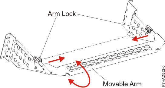

Power cord retainers are typically found at the rear of the unit and on the chassis or pedestal near the alternating current (AC) power cord input.
Systems that are rack mounted and are on rails should use the provided cable management arm.
Systems that are rack mounted, but are not on rails should use the provided rings, clamps, or straps.
Figure 1. Cable management bracket
