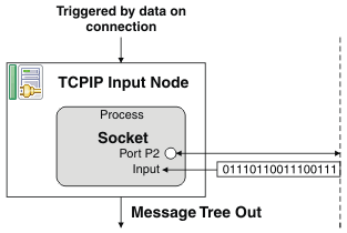

Input nodes
The input node allows access to a connection's input stream. The node is triggered by the arrival of data in the stream and starts processing the message flow. The input node controls thread and transaction management. The TCP/IP nodes are not transactional in the way that they interact with TCP/IP, but other nodes in the same flow can be transactional (for example, WebSphere® MQ nodes). The input node does not create a thread for every connection being used, but waits for two requirements to be met:
- A connection is available that still has an open input stream
- Data is available on the input stream (at least 1 byte)
For example, 1,000 TCP/IP connections can be handled by one input node that has only one additional instance. This situation is possible because the node does not poll the connections, but is triggered when the specified conditions are met.

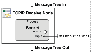

Receive nodes
The receive node is triggered to read data from a connection when a message arrives on its In terminal. It waits for data to arrive, then sends it to the Out terminal. You can configure the receive node to use a particular connection (by specifying a connection's ID) or to use any available connection. If the node is configured to use any available connection, it receives data from the first connection that has data available.

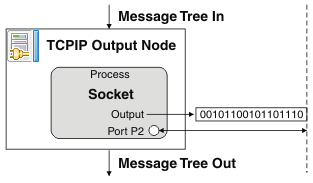

Output nodes
The output node sends data to a connection. It is triggered by a message arriving on its In terminal, then it sends the data contained in the message to the stream. The same message that is received in the node is sent to the Out terminal.
