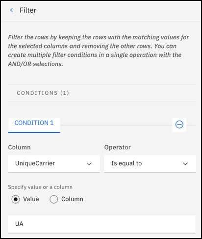

  4. Focus on the delays for a specific airline. This tutorial uses United Airlines (UA), but you can choose any airline.
    1. Click New step, and then choose the GUI operation Filter.
    2. Choose the UniqueCarrier column.
    3. For Operator, choose Is equal to.
    4. For Value, type the string for the airline for which you want to see delay information. For example, UA.
      Filter operation
    5. Click Apply. Scroll to the UniqueCarrier column to see the results.

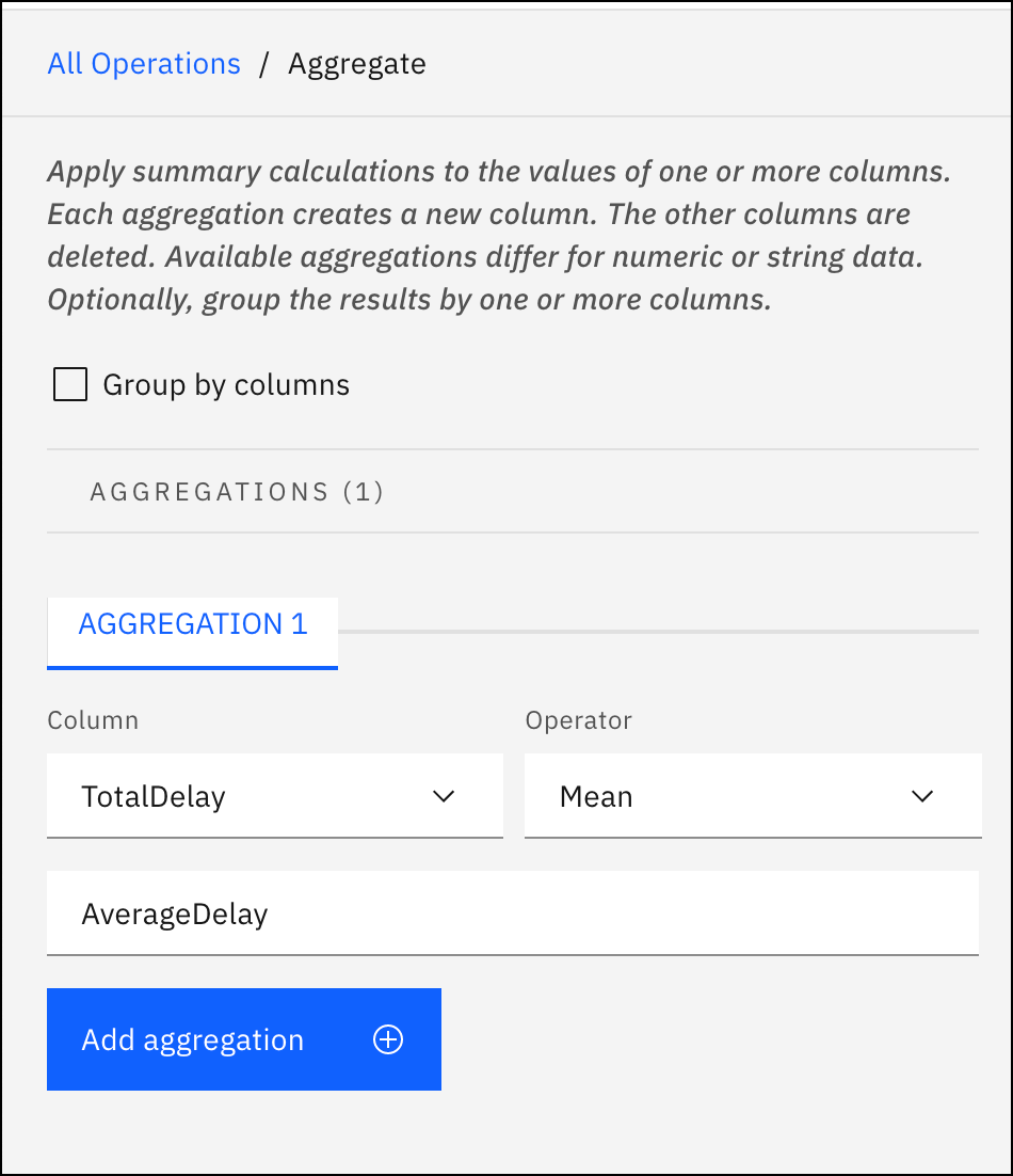

  8. Show the mean of the values of the TotalDelay column, and create a new AverageDelay column:
    1. Click New step, and then choose the GUI operation Aggregate.
    2. For the Column, select TotalDelay.
    3. For Operator, select Mean.
    4. For Name of the aggregated column, type AverageDelay.
      Aggregate operation
    5. Click Apply.
      The new column AverageDelay is the average of all the delay times.

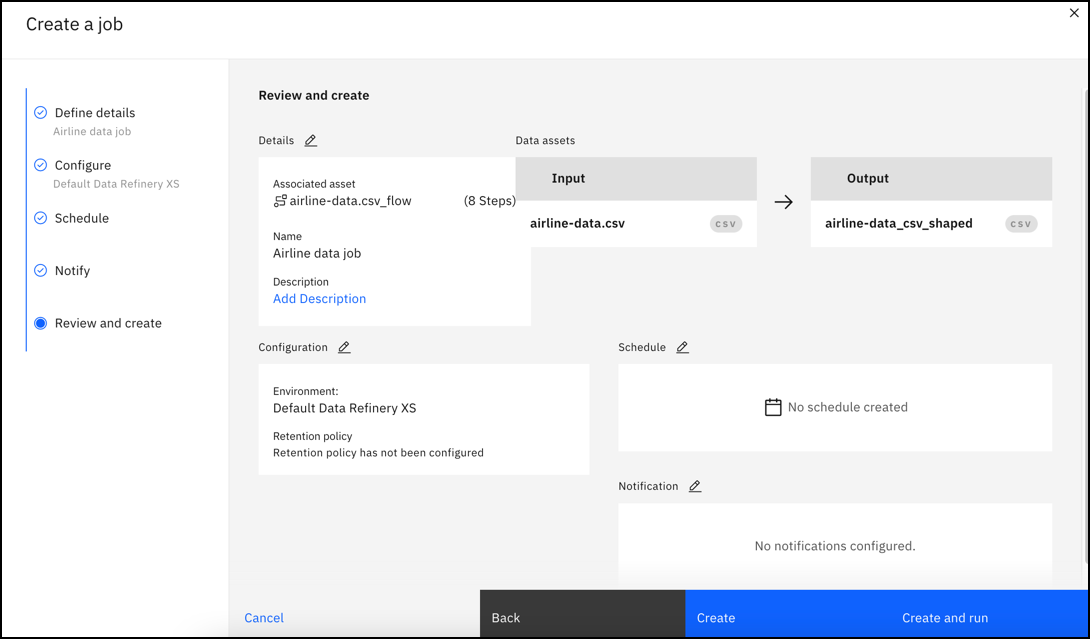

Task 5: Run a job for the Data Refinery flow
When you run a job for the Data Refinery flow, the steps are run on the entire data set. You select the runtime and add a one-time or repeating schedule. The output of the Data Refinery flow is added to the data assets in the project. Follow these steps to run a job to create the refined data set.
  1. From the Data Refinery toolbar, click the Jobs icon, and select Save and create a job.
  2. Type a name and description for the job, and click Next.
  3. Select a runtime environment, and click Next.
  4. (Optional) Click the toggle button to schedule a run. Specify the date, time and if you would like the job to repeat, and click Next.
  5. (Optional) Turn on notifications for this job, and click Next.
  6. Review the details, and click Create and run to run the job immediately.
    create job
  7. When the job is created, click the job details link in the notification to view the job in your project. Alternatively, you can navigate to the Jobs tab in the project, and click the job name to open it.
  8. When the Status for the job is Completed, use the project navigation trail to navigate back to the Assets tab in the project.
  9. Click the Data > Data assets section to see the output of the Data Refinery flow, airline-data_shaped.csv.
  10. Click the Flows > Data Refinery flows section to see the Data Refinery flow, airline-data.csv_flow.

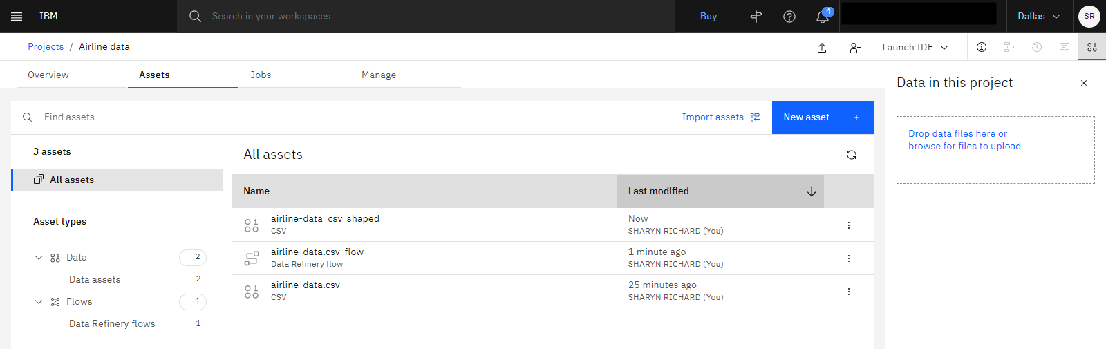

Task 7: View the data assets and your Data Refinery flow in your project
Now follow these steps to view the three data assets, the original, the first refined data set, and the second refined data set:
  1. When the job completes, go to the project page.
  2. Click the Assets tab.
  3. In the Data assets section, you will see the original data set that you uploaded and the output of the two Data Refinery flows.
    • airline-data_sorted_shaped.csv
    • airline-data_csv_shaped
    • airline-data.csv
  4. Click the airline-data_csv_shaped data asset to see the mean delay unsorted. Navigate back to the Assets tab.
  5. Click airline-data_sorted_shaped.csv data asset to see the mean delay sorted in descending order. Navigate back to the Assets tab.
  6. Click the Flows > Data Refinery flows section shows the Data Refinery flow: airline-data.csv_flow.
Checkpoint icon Check your progress
The following image shows the Assets tab with all of the assets displayed.
