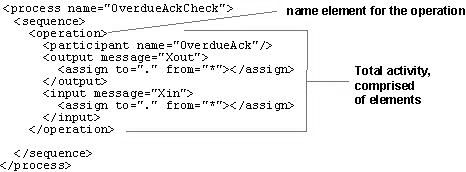

![](SI_vBPMLexample.jpg)
The elements between <operation> and </operation> define the particulars of the activity, including calling the EDI Overdue Acknowledgment Check service. The </operation> element indicates the conclusion of the operation activity.
If you create business process models by direct-coding, you are responsible for including all of the appropriate elements that make up activities. When you use the GPM to create your process models, the icons you include automatically create the required BPML element components (although you may also need to configure service parameters).
You can relate the example in the first figure to the GPM display in the following way:
- The Start icon provides the BPML code for the process name saved with the business process model.
- The Sequence Start icon provides the BPML for the sequence element.
- The participant name, output message, assign, and input message elements are provided by parameters associated with the EDI Overdue Acknowledgment Check service.
