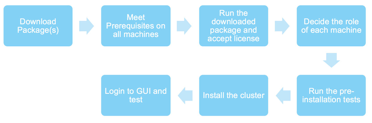

Use the following high-level steps to deploy IBM Spectrum LSF Suite for HPC to a cluster:
  1. Make sure your hosts satisfy the host, operating system requirements, network configuration, hardware, and other prerequisites that are described in Installation requirements.
  2. Download and extract the installation packages.
  3. Change directory to /opt/ibm/lsf_installer/playbook
  4. Edit the lsf-inventory file to list the hosts in the cluster and their roles.
  5. Edit the lsf-config.yml file to specify a cluster name, a shared directory, a JDBC connection string, and other cluster properties.
  6. Test the configuration and host access by running the commands ansible-playbook -i lsf-inventory lsf-config-test.yml and ansible-playbook -i lsf-inventory lsf-predeploy-test.yml.
  7. Run the command ansible-playbook -i lsf-inventory lsf-deploy.yml.
The following figure summarizes the entire installation workflow:

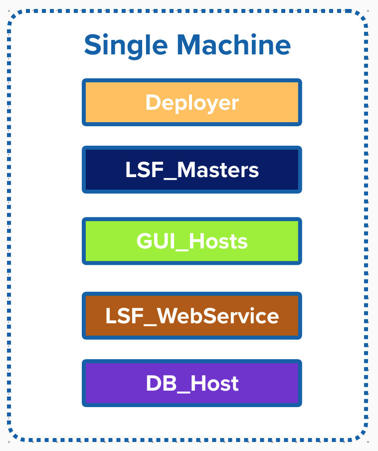

The following figure illustrates the simplest installation:
LSF Suite simplest installation
In this case, everything (deployment, LSF host, GUI server host, LSF Web Services host, database host) is installed on one host. This single-host installation is not a production configuration, but it is suitable to test IBM Spectrum LSF Suite for HPC.

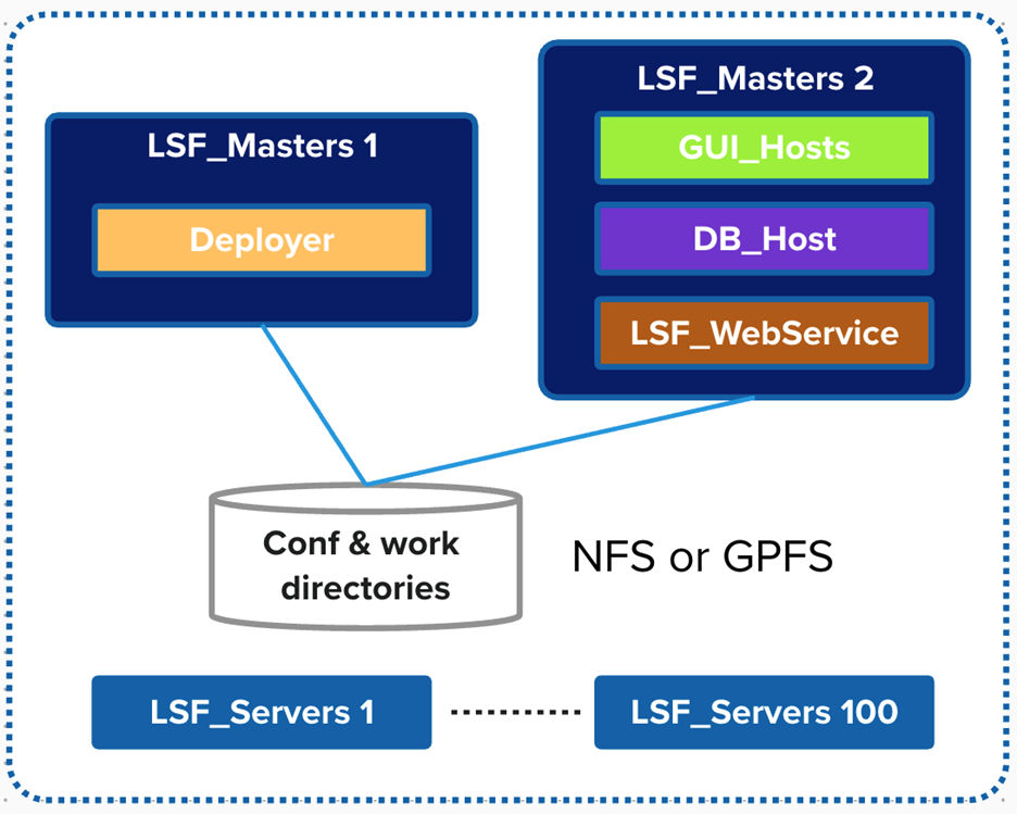

The following figure illustrates a small, production-ready cluster:
LSF Suite small-cluster installation
This cluster is configured with a host that also serves as the LSF Suite deployment host, and a second host that serves as a failover candidate host, GUI server, LSF Web Services host, and database host. A shared directory that contains the LSF work and configuration directories is mounted on both hosts. One hundred LSF servers are configured to run the workload.

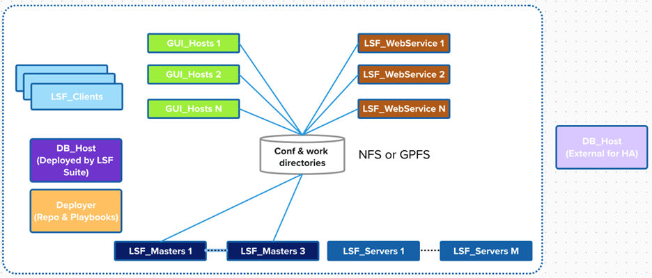

The following figure illustrates a large cluster:
LSF Suite large-cluster installation
This cluster installs three candidate hosts, several GUI server hosts, and several LSF Web Services hosts which are not defined from LSF hosts. There is a separate database host (a database host is external to the cluster for high availability). A separate deployment host is configured along with several LSF server hosts and LSF client hosts.
