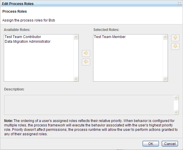

Because the predefined default Everyone role cannot be assigned, removed, or reordered, it does not appear in the Edit Process Roles window. All users in the repository have the Everyone role.

| Data Migration Administrator | You can use this role to allow administrators to create data that is exempt from the normal constraints that are enforced by process advisers. For example, if you need to migrate data into Engineering Test Management via the REST API, then this role would allow you to bypass the process advisor and migrate data that violates the version 4 process constraints. (The REST API lets you read and write data with out using the web interface.) You can combine this role with other roles, but you must place this role in the first position in the list of selected roles. |
Depending on your needs, you can create roles for testers, test leads, test managers, and other test team members, based on the Test Team Member role. You can use the Test Team Member role as a model and make slight variations in the operations that are allowed for each role.
