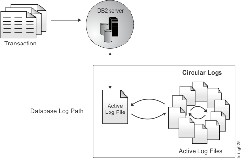

Circular logging is the default behavior when a new database is created (the logarchmeth1 and logarchmeth2 database configuration parameters are set to OFF). With this type of logging, only full, offline backups of the database are allowed. The database must be offline (inaccessible to users) when a full backup is taken. As the name suggests, circular logging uses a "ring" of online logs to provide recovery from transaction failures and system crashes. The logs are used and retained only to the point of ensuring the integrity of current transactions. Circular logging does not allow you to roll a database forward through transactions performed after the last full backup operation. All changes occurring since the last backup operation are lost. Since this type of restore operation recovers your data to the specific point-in-time at which a full backup was taken, it is called version recovery.
Figure 1. Circular Logging shows that the active log uses a ring of log files when circular logging is active

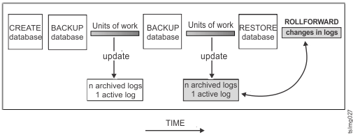

Figure 2. Rollforward recovery
Rollforward recovery.
Active logs are used during crash recovery to prevent a failure (system power or application error) from leaving a database in an inconsistent state. Active logs are located in the database log path directory.

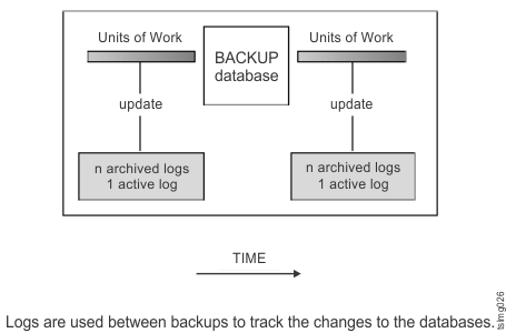

Taking online backups is only supported when the database is configured for archive logging. During an online backup operation, all activities against the database are logged. When an online backup image is restored, the logs must be rolled forward at least to the point-in-time at which the backup operation completed. For this to happen, the logs must have been archived and made available when the database is restored. After an online backup is complete, Db2 forces the currently active log to be closed, and as a result, it will be archived. This ensures that your online backup has a complete set of archived logs available for recovery.
Figure 3. Active and Archived Database Logs in Rollforward Recovery. There can be more than one active log in the case of a long-running transaction.
