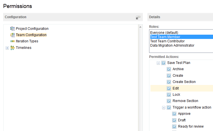

  9. Optional: Add a permission to a workflow action. The following image shows permissions for workflow actions.
    Workflow Trigger
    To add a permission to an action:
    1. In the project area, click Permissions.
    2. Select Project Configuration or Team Configuration.
    3. Select a role, such as Test Team Member.
    4. Under Quality Management, expand a permitted action, such as Save Test Plan.
    5. Expand Trigger a workflow action, and select the actions, such as Approve and Reject, to allow for the selected role.
    6. Click Save.
