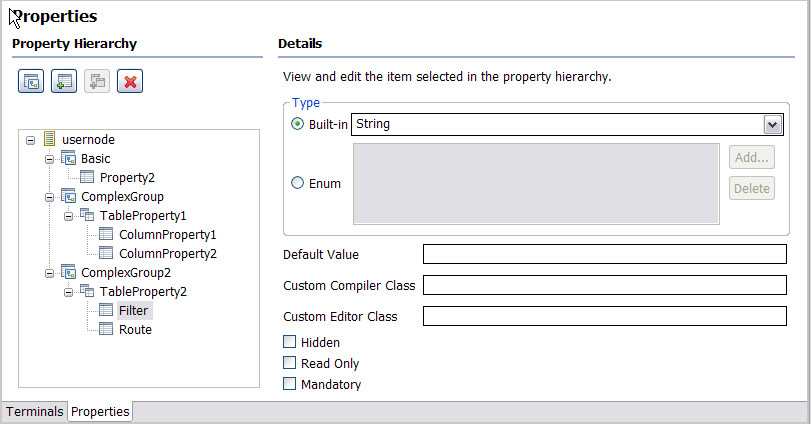

- To add a table property, select the name of a
property group in the Properties view and click Add
Table Property
. In addition to simple properties, a node can also have complex properties. A table property represents a repeating property of a complex type. The new property is added to the hierarchy as a child of the property group. A number of fields are displayed in the Details section where you can configure the table property.
- To add a column to an existing table, select
the name of the table property in the hierarchy, and click Add
Simple Property
. For example, the following figure shows the Property Hierarchy of the usernode, where Filter and Route columns have been added.

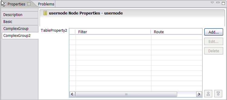

The following figure shows how the Table properties are rendered as a table in the Properties view, where you can add, edit, and delete values, and change the order of the values in the table.
