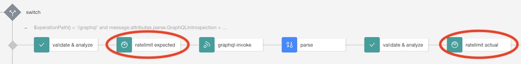

  • switch case:
    ($operationPath() = '/graphql' and message.attributes.parse.GraphQLIntrospection = 'not-introspection' and message.attributes.graphql.operationType != 'subscription')
    Two Rate limit policies with the following property settings:
    • Policy 1:
      Property Value
      Source Plan by Name
      Rate Limit Name graphql-type-cost
      Operation Consume
      Rate Limit Name graphql-field-cost
      Operation Consume
      Rate Limit Name graphql-input-type-cost
      Operation Consume
      This Rate limit policy limits calls to the GraphQL proxy API by calculating the expected cost of the query, and then correspondingly reducing the available cost balance that remains of the total configured cost limit. The expected cost is calculating by applying the weighting factors that have been attached to the types and fields in the GraphQL schema; for more information, see Using the GraphQL schema editor.
      The expected cost is calculated by the Validate policy that precedes the Rate limit policy and placed in the API context to be made available to the Rate limit policy. For details on the Validate policy, see Validate.

    • Policy 2:
      Property Value
      Source Plan by Name
      Operation Replenish
      Operation Replenish
      This Rate limit policy limits calls to the GraphQL proxy API by calculating the actual cost of the query, and then correspondingly reducing the available cost balance that remains of the total configured cost limit. The actual cost is calculating by applying the weighting factors that have been attached to the types and fields in the GraphQL schema; for more information, see Using the GraphQL schema editor.
      Note that if the actual cost is less than the expected cost, this Rate limit policy will appropriately restore some of the available cost balance that had been removed by Policy 1, thereby overriding the original actual cost limitation. The actual cost might be less than the expected cost if, for example, the query requested more data than was available in a backend database. You can delete one or other of these Rate limit policies from the assembly if desired.
      Note: Such unused cost is not restored if there are GraphQL response errors. The purpose of this restriction is to prevent malicious requests that cause large amounts of erroneous backend processing while only using a small amount of cost.
      The actual cost is calculated by the Validate policy that precedes the Rate limit policy and placed in the API context to be made available to the Rate limit policy. For details on the Validate policy, see Validate.
    The policies as they appear in the assembly UI are as follows:Screen capture showing rate limit policies for second switch case
