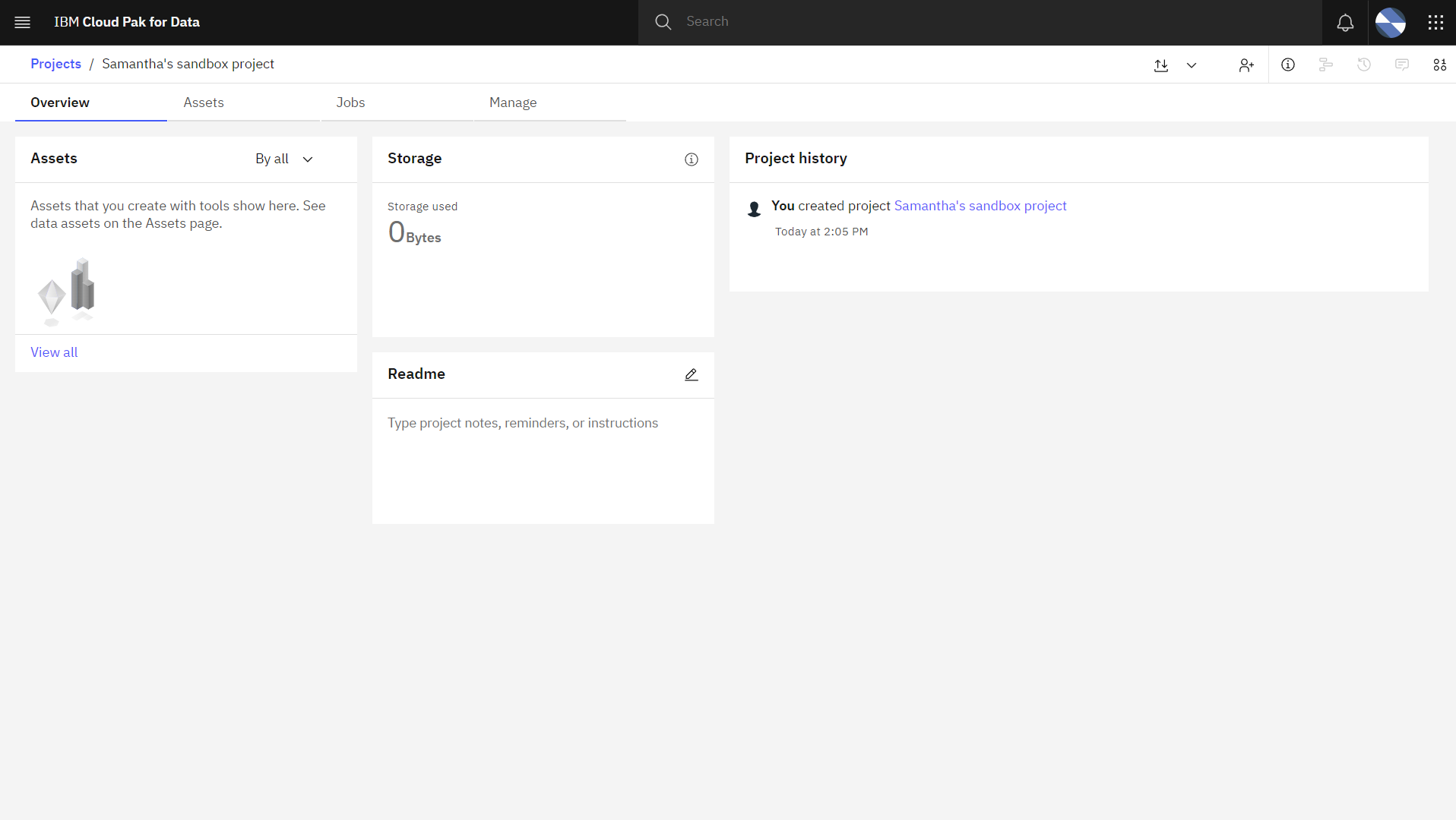

Checkpoint icon Check your progress
The following image shows the project overview page.
Project overview page

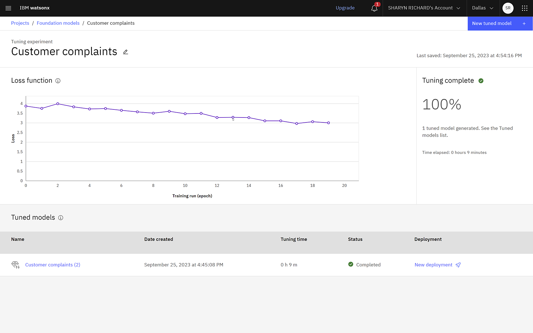

Task 6: Deploy your tuned model to a deployment space
When the experiment run is complete, you see the tuned model and the Loss function chart. Loss function measures the difference between predicted and actual results with each training run. Follow these steps to view the loss function chart and the tuned model:
  1. Review the Loss function chart. A downward sloping curve means that the model is getting better at generating the expected output.
    Completed tuning experiment
  2. Below the chart, click the Summarize customer complaints tuned model.

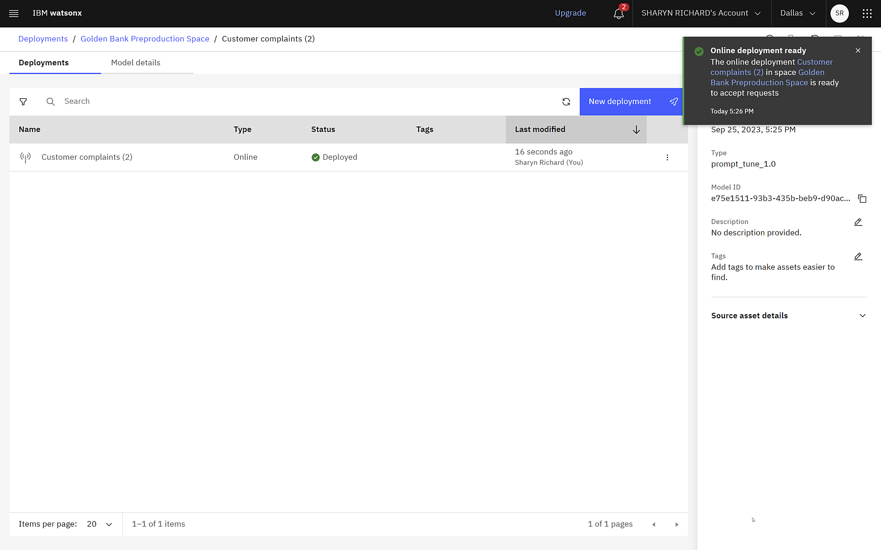

  8. Check the View deployment in deployment space after creating option.
  9. Click Create.
  10. On the Deployments page, click the Summarize customer complaints tuned model deployment to view the details.
The following image shows the deployment in the deployment space. You are now ready to test the deployed model.
