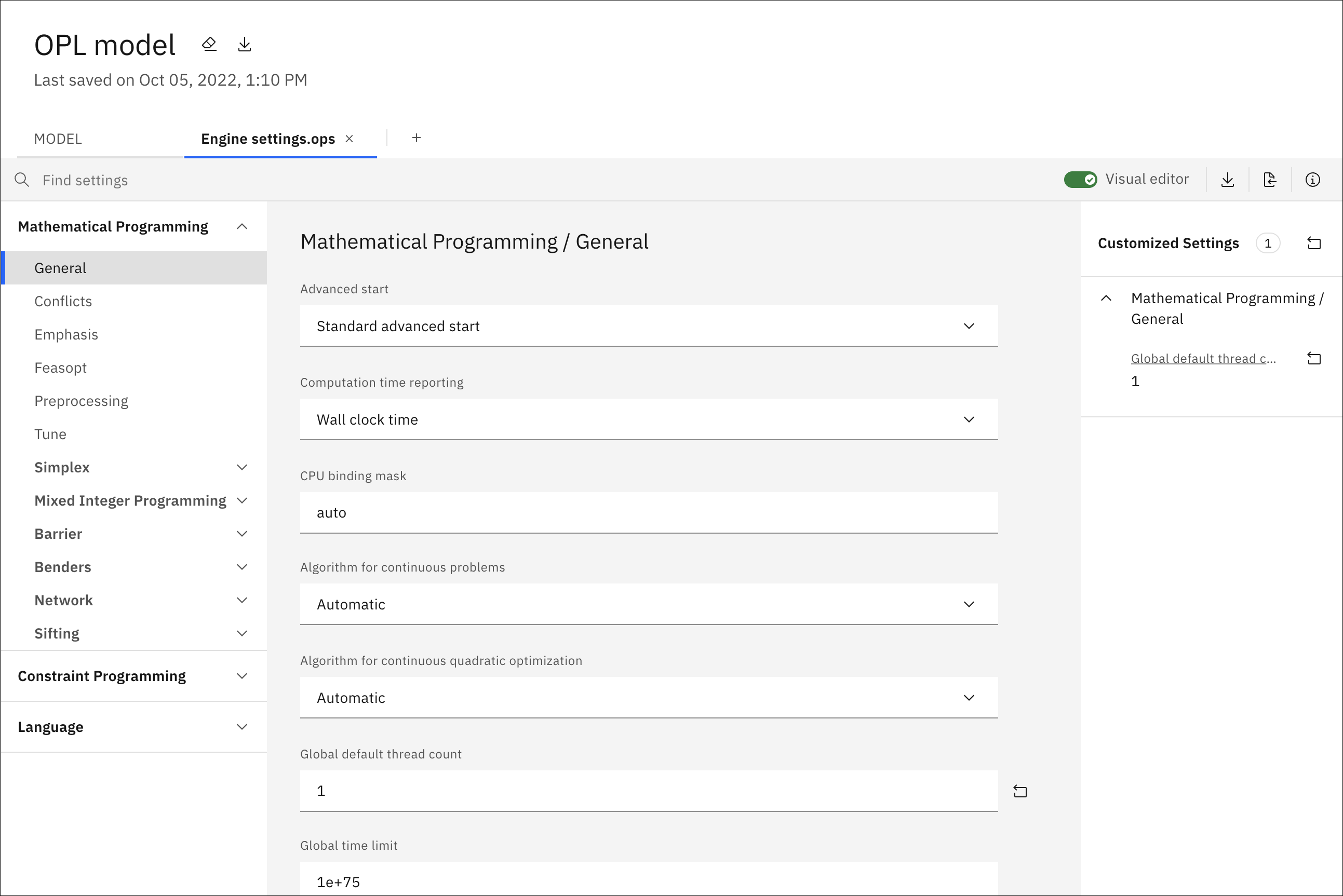

Click + (plus sign) and select Add engine settings file in the Build model view. The Visual editor opens where you can see the default parameter values, which are arranged in different categories, that you can customize for your model. You can also search for specific parameters by entering a name in the Find settings search field.
.OPL Engine settings .ops file shown open in Visual Editor view with one customized parameter
In this window, you can select different parameters or edit fields. If you modify the default parameters, a Customized Settings pane that lists your changes appears.

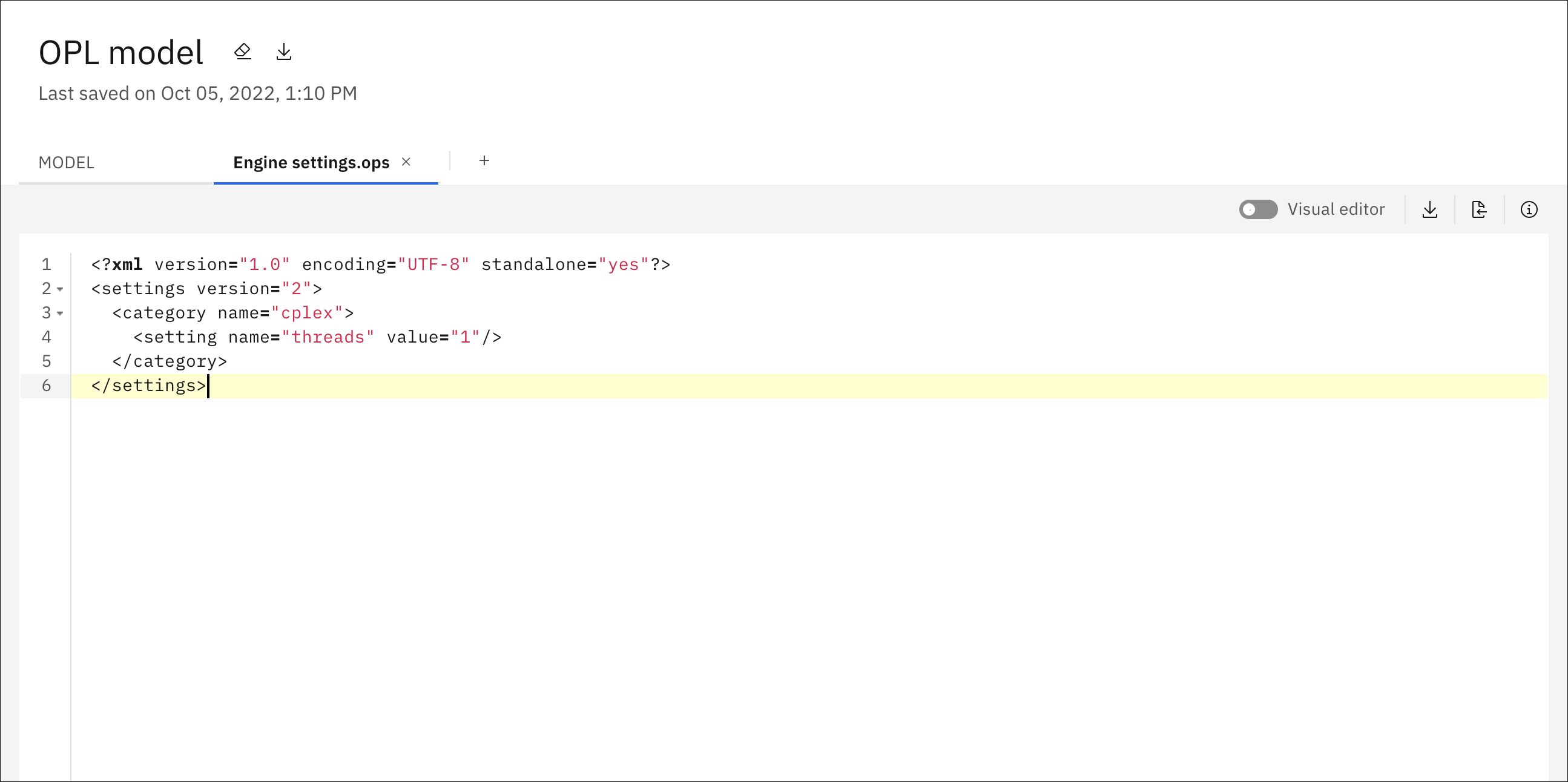

You can toggle the Visual editor switch to the off position to view your changes in an XML editor. The file, when displayed in the XML editor, only contains the parameters that you changed, and does not list all the default parameters. You can also edit the parameters in this XML editor and your changes are displayed in the Visual editor when you toggle the switch back to the on position.
XML editor showing modifications made to default engine setting parameters
