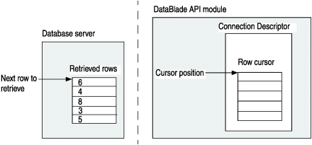

Fetch rows into a cursor
When mi_open_prepared_statement() successfully opens a cursor, the cursor is empty, with the cursor position pointing to the first location of the cursor, and the mi_get_result() function returns a status of MI_NO_MORE_RESULTS to indicate that the cursor does not contain rows.
The following figure shows the state of the explicit cursor that contains one integer column after mi_open_prepared_statement() executes.
Figure 1. Row cursor after mi_open_prepared_statement()
begin figure description - This figure is described in the surrounding text. - end figure description

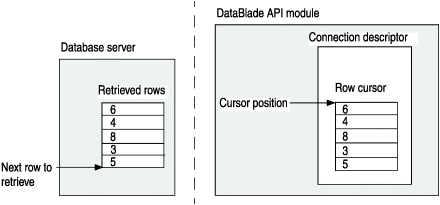

The following figure shows the state of a row cursor that Figure 1 defines after the following mi_fetch_statement() executes:
mi_fetch_statement(stmt_desc, MI_CURSOR_NEXT, 0, 0);
Figure 2. Fetching all retrieved rows into a cursor
After the rows are in the cursor, your DataBlade API module can access these rows one at a time with the mi_next_row() function. For more information, see Retrieving query data.

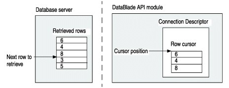

The mi_fetch_statement() for Figure 2 specified a value of zero, as the number of rows to fetch, which tells the function to fetch all retrieved rows. Figure 3 shows the state of the row cursor that Figure 1 defines when the mi_fetch_statement() function specifies a num_rows argument of three instead of zero, as follows:
mi_fetch_statement(stmt_desc, MI_CURSOR_NEXT, 0, 3);
Figure 3. Fetching first three rows into a cursor
