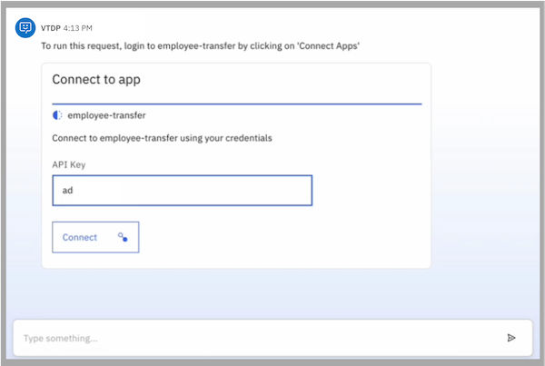

Adding tools that use member credentials to agentic workflows
You can add tools to agentic workflows that use member credentials for their connections. For more information about member credentials, see Member credentials.
If member credentials are not available at run time, the system prompts you to enter the credentials in the chat. If a tool uses multiple connections that require credentials, the system prompts you for each set of credentials as needed at run time.
After a connection is successfully established with member credentials, the system saves the credentials on the Manage > Connections > Credentials tab. You are not prompted for the credentials again after the connection succeeds. However, tools that use time-based authorization for connections might prompt you to reenter the credentials in the chat after a specified time interval.
