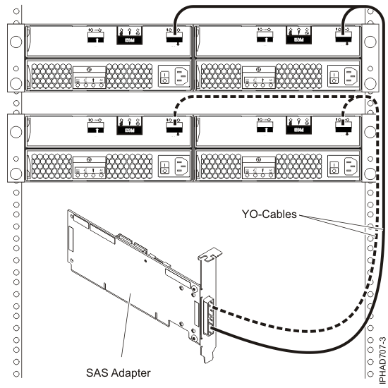

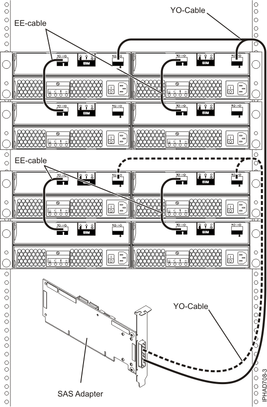

SAS adapter to 5886 disk expansion drawers
Figure 4, Figure 5, Figure 6, and Figure 7 illustrate connecting a SAS adapter to one, two, three, or four disk expansion drawers. It is also possible to connect three disk expansion drawers by omitting one of the cascaded drawers that are shown in Figure 6. Disk expansion drawers can be cascaded only one level deep.
When attaching only hard disk drives, it is also possible to cascade a second disk expansion drawer off two out of the three drawers for a maximum of five disk expansion drawers per adapter. See Figure 6. Disk expansion drawers can be cascaded only one level deep.

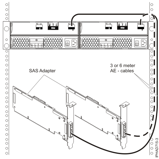

SAS adapter to media expansion drawer

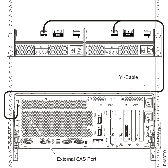

System external SAS port to disk expansion drawer

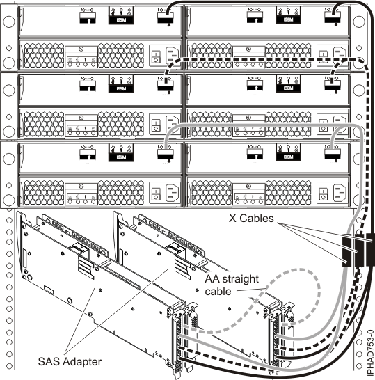

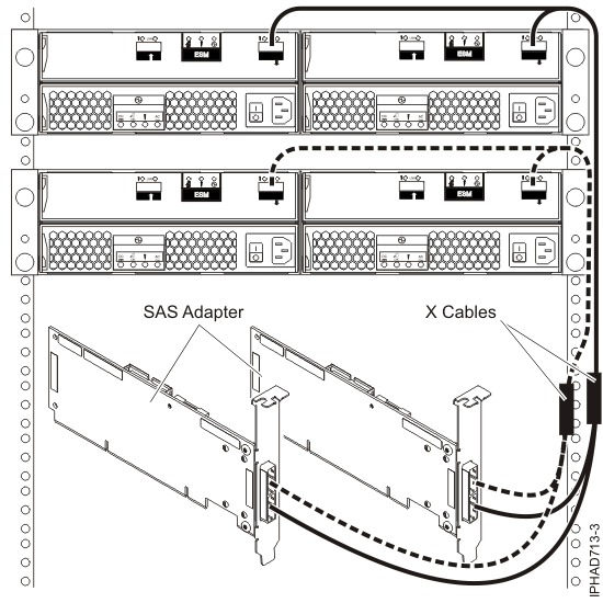

Two SAS adapters to 5886 disk expansion drawer multi-initiator high availability (HA) RAID configuration
Figure 13, Figure 14, Figure 15, and Figure 16 illustrate connecting two SAS adapters to one, two, or four disk expansion drawers in a RAID configuration. It is also possible to connect three disk expansion drawers by omitting one of the cascaded drawers that are shown in Figure 15. Disk expansion drawers can be cascaded only one level deep.
- The X cable must be routed along the right side of the rack frame.
- The X cable must be attached to the same numbered port on all adapters.
- Disk expansion drawers can be cascaded only one level deep.
- Any multi-initiator configuration with FC 5904, FC 5906, and FC 5908 adapters require an AA cable for connecting the two adapters with each other.

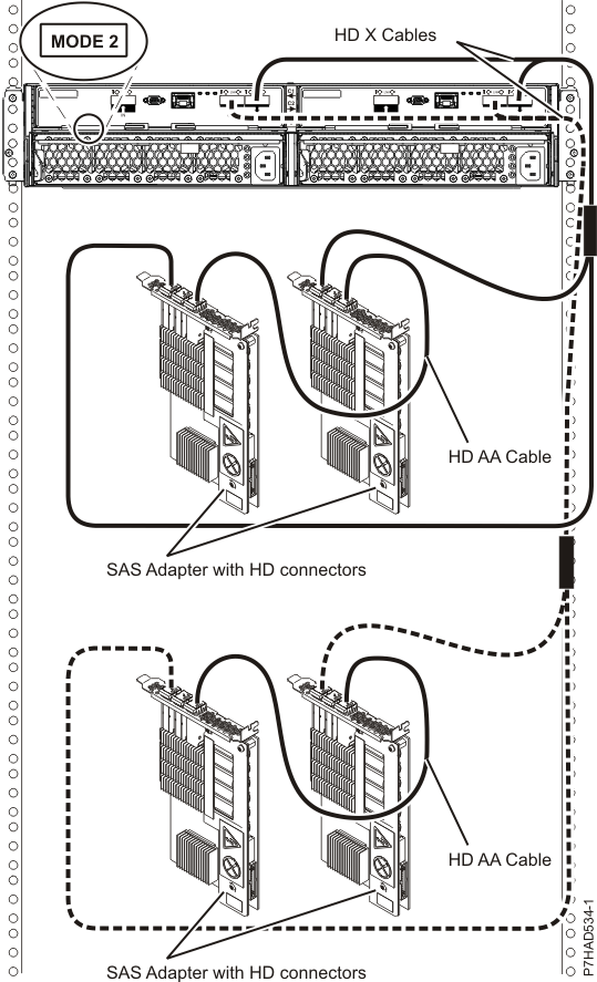

Two RAID SAS adapters with HD connectors to disk expansion drawer in a multi-initiator high availability (HA) mode
Figure 17, Figure 18, and Figure 19 illustrate connecting two SAS RAID adapters with HD connectors to one, two, or three disk expansion drawers in a multi-initiator HA mode.
Figure 20 illustrates connecting two pair of SAS RAID adapters with HD connectors to one disk expansion drawer in a multi-initiator HA mode.
- No cascading allowed for the 5887 storage drawer.
- The 5887 storage drawer is connected to same numbered port on each adapter.
- HD AA cable is required.
- The 5887 storage drawers are connected to same numbered port on each adapter.

unit enclosure to the top port in the SAS Storage Controller as shown
in the following figure.
Restriction: Internal disk drive sharing is only available when internal cable feature FC 1815 is installed from the DASD backplane to the read bulkhead of the system unit enclosure. Also FC 5662 175 MB cache RAID - dual IOA enablement card must not be installed. The SAS Storage Controller might be in any of the other slots that support it.
- Secure any extra cable.
- Attach the cable to the SAS port on the rear bulkhead of the system
- Start the system. For more information, see Starting the system or logical partition.
- Verify that the feature is installed and is working. For more information, see Verifying the installed part.
With this function installed, two of the six disks (D3 and D6) in the system enclosure is managed by the SAS storage controller adapter.
